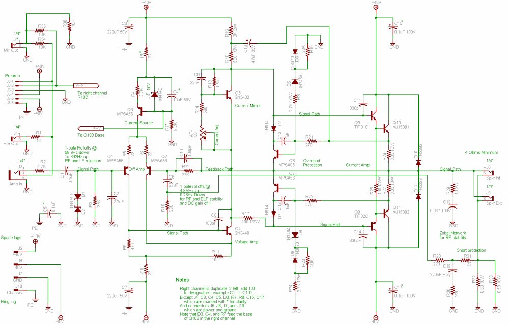

I have a guitar amp with a Lin topology power amp in it. The push-pull AB-class current drivers are made from TIP31C/32Cs Darlingtoned with MJ15001/002s. I can't find a good source for them, so I am looking at TIP41C/42Cs and 15003/004s as replacements. I believe from several things I have seen that these should be plug-n-play replacements, and I don't think I'll have to re-bias anything. According to the data sheets, the differences are that h(FE) is a bit higher, V(CE)sat is also a little higher-- but since they're biased fairly strongly into the active region, this shouldn't matter-- and V(BE)on is a little higher, which should somewhat offset the current gain difference. I'll be checking to make sure that they're into the active region, and the amp has a current limiter stage just before the push-pull stage. Has anyone had experience with doing something like this and could give me an idea if it will work OK?
I am also going to add a fan as well as some vent holes (I plan to drill vents in the bottom of the chassis and have the fan blow out- this will draw cool air across the power transistors and heat sink). This is where the problem came from in the first place- I played it too loud on a hot day and one of the drivers went intermittent on me. Does anyone know of anything that might help cool the amp more?
The amp has always been a little noisy, and it's definitely the power amp, not the preamp- I have switched jacks and I've tried it with shorting plugs to short the input. Breaking it open I found that the power supply is just a center-tap transformer at 2:1, a bridge rectifier across the ends of the secondary, and a pair of 6800uF caps, and that's it. I am planning to put a regulator on it; there is sufficient voltage to add a pair of diodes to the center tap and use two positive regulators, and I am getting a pair of LM338s with all the trimmings; I have a thread running asking for technical advice on the Power Supplies forum, but I think I've figured it all out, unless someone comes up with some last-minute problem. However, the designers have done some rather peculiar things with ground:
1. The speaker jacks are connected to a network with a pair of 0.68 ohm 10W resistors in parallel to ground, and a "T" with 220 and 22 ohm resistors on the arms and a 0.022uF cap and 10 ohm resistor in parallel to ground; the 22 ohm arm of the "T" goes to the 0.68 ohm resistors. This seems rather odd to me, and I suspect there might be some noise from a ground float as a result, but I also suspect that those 0.68 ohm resistors are a last-ditch effort to handle a shorted output. Does anyone know if this is a good conjecture on my part, and if this arrangement is likely to cause noise?
2. The heat sink is completely insulated from the transistors, but instead of tying it to ground directly, the designers have used a 0.1uF cap. I suspect that this was not a real great idea, and I intend to replace the cap with a jumper. Does anyone know of a reason why they would do this, and whether this could also be a source of noise?
3. I'm looking at the board, and there are- hold on to your hat- three grounds. The one tied into the center tap of the transformer goes to a lug that ties to the chassis, so that's normal- but then it goes out and gets split into two traces (yes, kids, I have two ground traces running side-by-side all the way across the amp board to the connector that goes to the preamp, and yes, both of them go to that connector, and then (and ONLY then) one of them connects to the main power amp ground). After being routed to the far side of the board, "ground" (whatever the heck "ground" means when there are three of them) then goes cruising back across the middle of the board to act as the actual ground that the amplifier uses for all its bypass caps and so forth- and all the way back where it came from, the same freakin trace goes past the place where the original split occurred, and there they are: three "ground" traces running right next to each other. And to top it all off, the schematic has one of the grounds labeled as "dirty ground." GAH!!!. Now it's my experience that ground problems are BAD in audio equipment, and this looks to me like the ground loop from the heart of evil. My tendency is to star ground everything- just go nuts with lugs and heavy-gauge wire. Does anyone know anything about why any sane individual would make a design with multiple different grounds when there isn't any indication that any of them are actually electrically isolated from one another? What am I missing here? Is this voodoo, or is there an actual design concern that I need to learn about here???
Thanks in advance for any help anyone can provide on these questions. If someone needs to see the schematic, I'll try to do an attachment- we'll see if it's actually readable at less than 1000 pixels across.
The schematic, for reference.

The transistors you mention will be suitable for replacement, however you will have to rebias the amp.
The bit you labelled "Current Mirror" Q5, is actually the bias circuit.
Some of the noise might well be the zener diode in the current source feeding the diff amp pair.

These 0.68R resistors are speaker current sensors, so that feedback is partially voltage sense and current sense. This gives the whole amp higher than hi-fi standard output imedenace and lets speaker to resonate at some 75-85Hz.
Proper grounding seems very hard to me here...

OK. I assume I'm pushing the V(CE) in the current driver just far enough up into the active region to ensure linear operation, for the one of the four transistors that is the lowest, right? That should be V(CE) just barely above V(CE)sat(max) from the data sheets for the one of the four of Q8-Q11 that has the lowest V(CE) with relation to its particular V(CE)sat(max), if I understand the operation of the amp correctly; that will give the maximum possible loadline for all four transistors, and output will then be limited by the least of, current available from the supply, top of the lowest loadline.
I believe that I should be starting with the pot AP-1 at minimum resistance, which should give minimum current through Q4, and slowly crank the resistance up, checking the V(CE) on Q8-Q11, and watching the current thru Q4 to make sure it doesn't get too high; if it does, then I'll have to consider changing the value of R16 to a higher value, I'll start with 750. If, on the other hand, I can't get the current high enough, then I'll have to move the bias point of Q5 up a little bit by reducing R14 and/or increasing R13, as long as this doesn't push Q4's current too high.
Once I have the correct minimum V(CE) for Q8-Q11, then I want to check the quiescent position of Q4 on its loadline and make sure it's as close as practical to the center of the loadline. If not, adjust R16, R17, and finally R13/R14, and as a final position consider adding a resistor to the collector of Q5 to mirror R17.
Do I have that right?

The transistors showed up today, and it looks like they were plug-n-play after all. I'm going to do more with it tomorrow, but at this point, it looks like the regulators removed the noise and the adjustments needed for biasing were minimal. I made two modifications besides changing the output transistors and adding the regulators:
1. The heat sink was bypassed to ground with a .1uF cap. I replaced this with a jumper.
2. The ground from the service was attached to the case, but the ground from the amp was not. I attached the ground from the amp to the case where the power enters the Lin amp.
With 100mA of quiescent (shorted input) current at the emitters of the MJ15003/004s, the amp sounds just a bit better than it did with the original MJ15001/002s; the biasing of the Class-A voltage amplifier was not significantly disturbed; it is still within a very small percentage of the center of the load line, in fact it is just slightly better than it was. The power supply regulation project failed, though; I will now buy a toroid with two secondaries and make it work. Anybody wanna buy a used transformer, cheap? Just kidding. It's bench supply meat. I may build some more Lin amps and it would make a pretty good test supply for that.
Direct-coupling the heatsink does seem to have improved the hum slightly, but that may be subjective, and I intend to be picky. I've also observed that there is significant hum in the preamp as well, so it's clear to me that regulated power is mandatory in this application. That was there all along, and of course it doesn't matter for that what I do to the Lin amp. I decided to leave ground alone other than to ground the heatsink; after I get the supply regulated, I'll run an A/B taste test to see whether a capacitor or jumper is more appropriate, I couldn't tell for sure with all the hum from the ripple. :p
Hey, I tried bypassing the base of the diff amp current source transistor to ground and then to +40V with a 0.1uF cap, and it didn't do a dang thing for me. I thought of increasing the 220uF cap to ground from the +40V rail right next to where the Zener gets its supply, but didn't bother doing anything about it; my expectation is that regulating the power supply will correct the problem if that's it.

There's a mistake in the schematic;- C16 is shown connected to top end of R28. It should be bottom end of R28 to C16.
Since R28 is 0r33 it may not make a lot of difference.
The protection circuit seems to be a little unusual and I suspect not very efficient, particularly in view of the mishap that caused the overheating.
I note you managed to bias the output stage but your description of the procedure you were planning to follow could have blown up the output stage. The label saying current mirror is actually next to the Vbe multiplier (as poster said). You seem to understand the effect of changing resistor values but for first start up after component changes you should firstly set the multplier to MAXIMUM resistance to MINIMISE the voltage bias across the output stage. Secondly you would be wise to ALWAYS start up a project on test through a mains light bulb to reduce the risk of blow up.

There is another fatal error in the schematic, that is that the right leg of the LTP is connected not to the same -ve rail as the rest of the circuit, but to the VAS emitter, which is incorrect.
The LTP CCS is also wrongly implemented. Either R4 or D3 will serve no purpose and the Vref generation I suspect with just a quick look is all wrong. It's also bad practice to take out the feed from Vref like that as you open it up to picking up noise etc.

my circuit analysis is not too hot but I think the VAS is connected as a folded cascode. It looks similar and the collector resistor ratio looks about right for that topology. R9 voltage drives the base in common emitter (inverting) and R11 voltage drives the emitter in common base (non inverting). Output from VAS is inverted from both sides of the LTP.
The CCS generates a constant voltage across the series pair of R4 and Vbe of Q3. This forces a constant current ([10-0.7]/2.7=3.4mA) through the resistor and C10 tries to hold the constant voltage steady when dynamically loaded.

No, I absolutely confirm C16 is present both on the original design schematics and on board. That's precisely how it's built. It connects the emitter of Q10 to the voltage divider of R15 and R16.
I also confirm the existence and accuracy of R8, R4, D3, and R18, as well as R9 and R11. There are no drawing mistakes. The schematic you see is the circuit board in my amp.
My impression of C10, BTW, was that it acted with R12, C6, and R10 to cause a 1-pole rolloff above 4.8MHz and below 0.26Hz, for DC unity gain and high-frequency stability, promoted by the negative feedback to the diff amp Q1 and Q2.

the CCS and input filters are all OK.
The NFB DC block and bass roll off are set excessively low but should not cause a problem. Slight performance benefits may accrue from adjustment to the input filter (59Hz) and NFB roll-off (22Hz) frequencies, but due to the specialised nature of the amp may not be worth the effort to alter.
The main high frequency roll of is due to C8, the Miller compensation cap. This is a cheap and cheerful method of ensuring stability in the amplifier and a little bit of stability adjustment from C10 is usually all that is necessary for a well behaved amp in mass production. It works and it is often used.
Prior to the C8 roll off, the input filter, as you have correctly noted, reduces the audio response to -3db @ 15kHz, about -1db @ 7.6kHz. In view of the harmonics the guitar is capable of and your speaker response do you think there is any advantage in opening up the HF filter by say half an octave?
Do you use the mix out or the pre out? They both have medium to high source impedance. Very short cables and low input capacitance on the next stage are vital.
