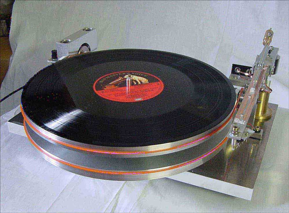

Arcane helicopter technology filters down to audio
Anyone willing to try making one of these? It's another crazy 47 Labs product. Not much info on their site yet. Just a negative photo which I put through photoshop to see properly here. It has one belt doubled back over two stacked, counter-rotating platters. Any thoughts on the reasoning behind this? Maybe its plinth is so lightweight that it would suffer from torque reaction without this.
Max
GR=1
How about a simple GR=SQRT(JL/JM) implementation. Two identical DD TTs driven with GR=1 and a drive speed of 33 RPM.
Low drive speed is good, yes? Rotational intertial of load and motor are equal; just remember to put a record or anything else you will be using on the drive side too.
