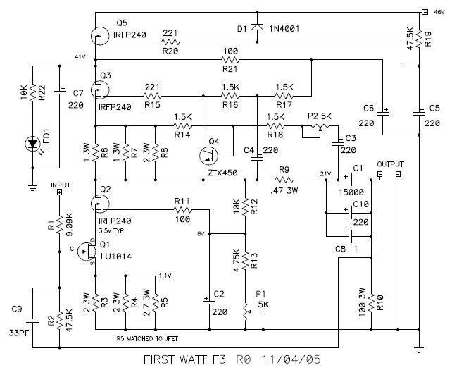

Increase Zin of amp
Excuse me for butting in with a slightly off-topic question -
The Zin of the F3 (ZV9, etc) power amp is only 10K and I'm using a buffer after the L'speed to make it function (remarkably well) but, as George has said, this is not ideal.
Can this input Z be increased to 100K without an input buffer stage?

Hi James, Nelsons amps are not the norm input wise, his earlier Threshold Stasis could be increased easily, via the input resistor (also fet input), I've done a couple of them without having dc offset problems, but the F3 is a different beast.
I know he reads this Lightspeed thread as I've had comunications with him, he is very interested in the Lightspeed progress, so maybe he will reply to this question better than I, if not in a couple of days I will ask him to contribute.
Cheers George

Re: Increase Zin of amp
In a word, no.
You will need a buffer. If you can't come up with one, I do have
a nice 100K input JFET circuit scheduled for publication early this
year.
