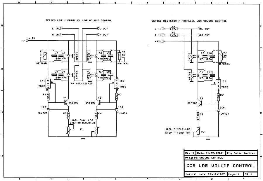

Obviously the suggested method of sorting LDRs for matching curves at constant voltage works to everyone's satisfaction. But in the spirit of great mousetrap designers everywhere, I would like to ask this dumb question:
Why not drive the LEDs with current instead of voltage, as suggested by Silonex? There are LED driver chips available which will drive LEDs to variable current with precision. Like these app note from Maxim.
Any thoughts?
That is exactly what I was thinking for some time! Couldn’t get rid of that idea in my head so I made a test setup to be able to compare between the original Lightspeed and a constant current source (CCS) version, as a volume control for my pre-amp. I connected the LED’s of the NSL-32SR2S by a connector to be able to switch between the two versions in a few seconds.
To make a long story short……the current source version is sounding MUCH better!! I am not talking about small differences here!
There is one problem to cope with. In my design the constant current also flows through the potentiometer (100k) which sets the current through the LED’s. That gave some severe crackling at the highest volume settings. Potentiometers don’t like DC voltage and with constant current things even get worse. So I used my DACT stepped attenuator, which was already in my pre-amp, to control the current sources. With the DACT everything is dead silent.
There is one other topic here in this thread that pops up from time to time, and that is the question what is best sounding: series LDR / parallel LDR or series resistor / parallel LDR. I did some additional listening tests to cover this topic as well. In my tube pre-amp I have some gain to waste, so the series resistor is no problem. I tested with the famous Shinkoh 47k tatalum resistors. The series LDR / parallel LDR combination sounds so spatial (also due to the CCS) that in my system it is to much sometimes. I also missed some of the focus and directness that the resistor / LDR version has. And voices and instruments have a more natural timbre with the resistor version. So I prefer the series resistor / parallel LDR version in my setup. That is to say, in my system and with my ears. Someone else could judge different because both sound very good.
The overall sonic difference between the DACT volume control (in a shunt configuration in my case) I used before and CCS LDR volume control is phenomenal.

This is how I did it!!
The current source is built round a voltage reference. In this case a TLV431, which has an internal reference voltage of 1.24V. But it is also possible to use other references such as TL431 (2.45V) or LM336-2.5 (2.5V) or others. To get an even more stable reference voltage, I used a LM317 current source to bias the TLV431.
The current range of this current source depends on the reference voltage of the chosen device, the potentiometer value and set resistor R2/R4 value. With the set resistor you can set the maximum value of the current source: I = Vref / R2. In this example 10.3 mA. And by turning the attenuator (I use a DACT stepped attenuator) fully clockwise this value drops to I = 1.24 / 100k = 12.4uA. This gives on de LDR side a range of about 48 Ohm to 20 kOhm. But you can of course choose other values for the reference or the attenuator to get the desired range. When you are using a 2 pin reference it is also possible to influence the range by using a darlington transistor instead of a normal transistor, because the Vbe is subtracted from the reference voltage.
The optional 2 Meg potentiometers are for calibration purposes. With these pots you can shunt a small amount of current to get perfectly matched channels.
The sound of this CCS volume control is really great and outperforms the original design with ease (see also my previous post).
