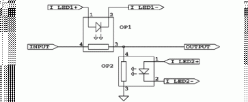

And this was for my Mk I version with a series resitor and just one shunt LDR per channel.
The MK II sounds better than the MK I, and has a much more constant input and output impedance around 7K-10K And it does not have the distortion peak at -6db like the MK I has.
Cheers George
Cheers George

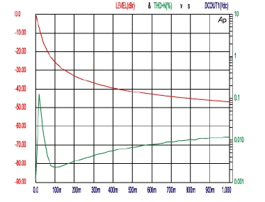

georgehifi said:I remember now this was for the way I use it now in my MKII version for the last 5 years , two ldr's per channel in series/shunt arrangement.
That's an interesting graph.
You can see the point where the series and shunt LDR's are the same
value, at this point their non linearities should cancel provided each
LDR has very similar characteristics.
I'd like to see an FFT of just the single version and how far down
H3 is from H2. If the LDR is used in fully balanced shunt mode then
H2 will be largely cancelled and we will be left with mainly H3. If H3 is a
long way down - well that's a good thing
I'm sure Nelson is already thinking of this!
Terry

Terry Demol said:I'm sure Nelson is already thinking of this!
I am thinking that the X axis labeling is of no value. What is
needed is the reference AC input for the dBr on the graphs.
Silonex graphs are confusing
I am really glad that I am not the only one who didn't understand that graph. I can't find the relation between dBr and x-axis. Normally, or as far as I understood, the dB-value has to rise the higher the current (or voltage) is. But not as shown.
Regards
Thomas
Regards
Thomas

http://www1.silonex.com/audiohm/levelcontrol.html
This webpage from Silonex explains what the graphs that were posted here mean, under what conditions they were measured, etc.
The X-axis is the control voltage of a constant current source circuit used to drive the LEDs, i.e. no meaning for the audio performance. You might wish to colorate the left Y axis (attenuation) to the right Y axis (THD).
From there I think you can draw your own conclusions what attenuation band you would use most often and then which configuration offers the least distortion.
Patrick
Patrick

Hi
today I got my 12 NSL-32SR2S: 6x2C, 4x2D, 2x2F.
I started measuring with my 5V PSU and my 10 Euro multimeter. I measured only resistance! My main measuring was after 2 minutes. First I tried 20 minutes but that was too boring. There is a little R shift in time.
I soldered a 100k log pot and 100 Ohm R between V+ and LED+.
I tested with 0 Ohm (~25 Ohm LDR), 18.6 kOhm (~426-528Ohm LDR after 2 minutes) and 92.5 kOhm (~1.9 - 2.64 kOhm LDR).
But with 95 kOhm (max of the pot) I got 3.3 kOhm. How will I simulate a 10k pot with the Lightspeed mkII circuit if the max. LDR resistance is only 3.3 kOhm???
Regards
Thomas
Hi
Regards
Thomas
Re: Too less resistance
Series/Shunt arrangement will give a resemblance to a 7-10k pot.
Cheers George
Regards
Thomas
Cheers George

Sorry, but I got other results.
If you assume the Lightspeed configuration as a voltage divider with input voltage of around 2V. Then you have R1 with 3.3K Rmax (with 100k pot for LED) and R2 with 25 Ohm Rmin, you got an attenuation of about -42dB as highest attenuation. With a 10k pot you got -80dB and with a 7k pot -77dB.
The main problem is that the lowest resistance is about 25 Ohms. To receive the same effect like a 10k pot (-80dB), the value of R1 has to increase to about 250k. But then your impedance for most amps is very high!
Regards
Thomas
Cheers George
Regards
Thomas
With matched NSL-32SR2S controled by a 100k log pot for the 5vdc this is what I measured, between 7-10k depending on matching, this was backed up by pannelhead and others who have built it as per my circuit diagram, if you are getting something else, maybe your matching isn't tight enough?
Cheers George
Cheers George
