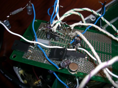

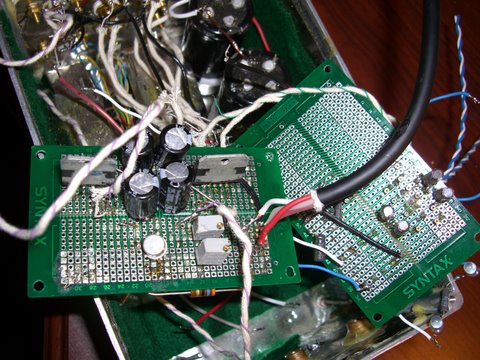

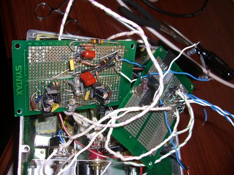

I have a passive and an active with LDR volume control. I think maybe the passive is better, but the passive is a 10K control and the one on the AD815 is a 22 - 25K.
The active is set up with a gain of 2. Also, I am not sure about using a passive on an amp with a 27K input. All mine have 100K, that works great with the passive.
I am pulling it apart tonight, maybe post pics of the fancy filtering on the LDR's.
