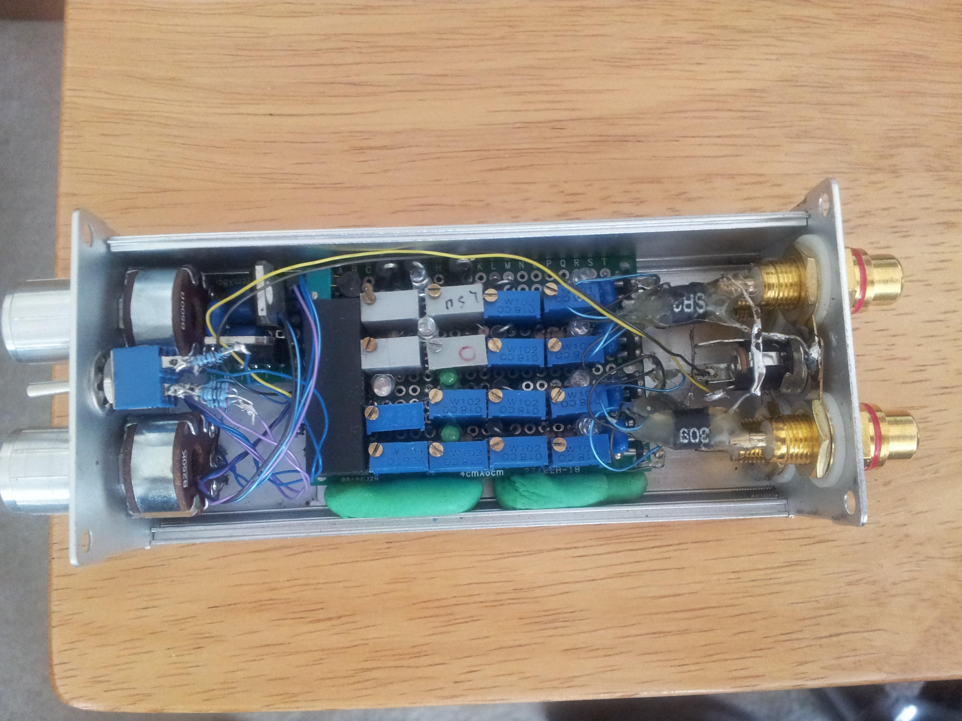

I had built one used four trimmer for each LDR's. each LDR can independent
adjusted the resistance at four position of the pot. 7, 9, 12 and 5 O'clock.
For series LDR I adjusted at 7.5 O'clock= 20kr, 9=19kr, 12=15kr, 5= 50r, at
7 O'clock position the series LDR will open the resistor is greater than 20mr
the output is dead silent.
For shunt LDR at 7 O'clock=40r,9=1kr,12=5kr,5=20kr.
This attenuator had built in the channel balance pot and high/low impedance select switch also. The one I used now I adjusted high to 20kr and low for 10kr.

I recently was sent a DIY implementation of a Lightspeed for a look. The gentleman had issues with series LDRs not changing value and the balance being off to boot. Here he had done a point to point on breadboard using largish gauge wires as signal and power wires. The problem he had was that it took so much heat to get the wires to accept solder that the LDRs were damaged and in fact one gang of the control pot was damaged so that it no longer worked, while the other gang was okay. Heat kills.
I build LDR attenuators from time to time and sometimes I will find that the LDRs match according to my datasheets but past the max value of my datasheets they do NOT match. I never assume that they will but we can always hope.
With this build I have been able to solve the problem. Usually its one LDR of the 4 that is misbehaving at higher values. So lets say that at max resistance its sitting at 14k and its mate is around 12k and lets say this permeates a bit lower so that at 2k they are a great match and up to 6k they are a decent match and beyond they seem to be hundreds of ohms away from each other. I can fix this with a high value resistor in parallel with the misbehaving LDR. Oh LORD! You cant be serious! A real resistor in the signal?! Well, yes its a very high value that usually fixes the problem and its in parallel with a relatively low value LDR so the amount of signal passing the resistor is quite small in comparison to the offending LDR and to my ears and my Audio Precision the sound is not compromised subjectively or objectively. I start with a 249k and work my way to two 249k in parallel then try a 100k or a 75k. This is usually all it takes.. one of these options will make the problem disappear.
This brings us to gootee's suggestion about parallel LDRs. I made a batch of 10 of these boards a few years ago. I still have one of them. I goofed them because I designed it using the default pin sizes in my pcb layout software and never expanded them. SO I had to drill out several of them and then never rebuilt them. One reason only. It was just beginning to be to much for the builders. I was considering 8 LDRs where 4 are dynamic and 4 stay the same value during operation for fine tuning balance and for limiting max resistance. It works and its nice.
Back to matching: I match up to an average of 6k for a few reasons. 1: 6k sounds fantastic to me compared to other values so thats a subjective reason. 2: LDRs are relatively stable at 6k. They start to get a little squirrely around 5k but 6k is not to bad. Squirrely meaning affected to a greater degree by heat. So if I match to an average of 6k I can be sure I am selling the customer a reality up to that point. When I say an average of 6k I mean that I choose a voltage and current that results in most of the LDRs on the test boards to be grouping around 6k. Still I will have many up into 12-15k but most at 6k.
In no way should anyone assume that a set of LDRs that are tested to, lets say 8k, should be a great match at 15k. They might be but I dont know if they are.
So some things can be done here. If its a Lightspeed implementation a trimmer of a few hundred K can be placed in rheostat mode across each of the gangs of the 100k control pot. Max resistance of the LDRs can be brought a bit lower. Lower means more stable. So you can now control your Lightspeed's total resistance.
