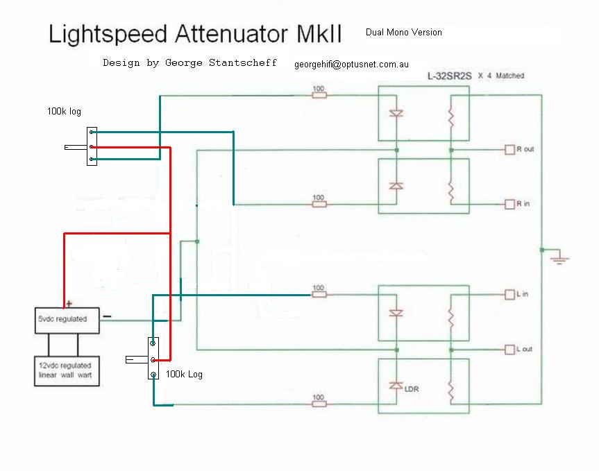

Suitable volumn pots for LSA
I would like to use two mono pots instead of a dual for better control of channel balance. Can someone recommend a suitable device from Mouser or Digikey. Digikey has KA1041S28-ND, would this be ok ?
Also my current active preamp uses two 10k audio taper volumn pots, can these be used with the LSA ?

It was not a mistake that dual section pots were recommended above.
If you go dual mono with the Lightspeed design, you'll still need to buy quantity 2 dual section pots.
There is no way that 2 single section pots will work for the lightspeed implementation of the circuit.
One pot section drives the LEDs for the upper (series R) LEDs, the 2nd section of the dual pot drives the lower LEDs (shunt R). In the standard configuration, each pot section drives both L and R LEDs.
So buy 2 100K dual gang pots for dual mono.
