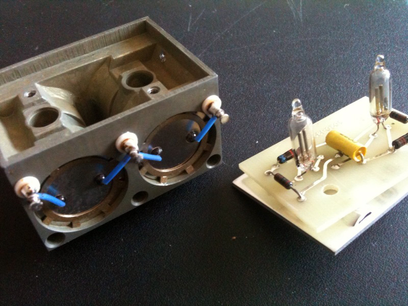

1 Megohm when turned off? Thats not a NSL32SR2 or an NSL32SR3. Sounds like a NSL32 or NSL32SR5, if its a Silonex Audiohm product. Ooh, or a combo of one of those for series and SR2 for shunt..
Cant wait to see pics of that massive optocoupler from HP. From a printer? That would make sense. Sounds fun :)

Diameter of each plate is 22mm.
If you can get a hp 3420b cheap somewhere...
Agilent HP 3420B
