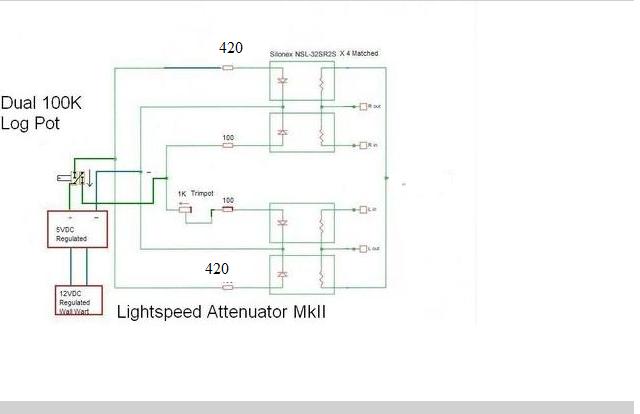

LDR pre
George,
I stricly follow your cicut. Dula100K ( read around 97k).No soldering. Connected with screw terminal. May be damaged piece.
Repalced the shunt LDRs with no problem.
Now question is :-
with 100 Ohms series resister it is showing 25 Ohms and increased to 420 oms to get around 46 ohms. 440 oms is ion shunt ony. Series LDR series resister remain 100 Ohms in both channel.
Question is will this make amy difference in sound or volume compared to 50 ohms LDR and 100 oms series for shunt and series as per your MK II. pLS SEE BELOW. Unforunately he sound was different. Any reason
see file attached.

Are you able to attain channel balance with the 1k calibration trimpot (only on the louder of the two channels) with all the 4 X 100ohms insitu?
Cheers George
If not then your ldr's are not well matched, I match all 4 at 2.5mA 5mA 10mA and 20mA if you only match up pairs, series and then shunts you will change the progressive feel of the volume control, instead of behaving like a log pot it can come on too fast at the begining and have nothing at the end.
Cheers George
Cheers George
Also as a quick check to see if one of your LDR's has gone west, short out the (1k trimmer) and by adjusting the volume control to get even voltage on the ldr side of the 4 x 100ohm resistors to ground, (you can get this very precise if you have used 1% metal film 100ohm resistors), when you have the exact same voltage then all 4 ldr's should measure similar resistances, if you have a funny one it will be wildly out compared to the other three either the led section has gone or the ldr section has gone.
Cheers George
Cheers George
George,
tank you for your reply. That make sense.
Wen changed from 100 R to 420R in shunt LDR only ( removed the Trim pot)
channel loudness is not quite audible. Looks like almost in the dead centre.
I made another one yesterday wih one more set . expecting I can get 50 ohms without adjustments. But got only 25 Ohms and But Music is audiible even if pwer is removed from the LDR. Will pay hrs will not die
I still I do not know.
Technically is it right to change the value of the shunt LR to get around 50ohms. Is it a compramise.
thanks

George
Thank you for the reply. That is what I aslo thought. Your advise to people like me is quite valuable.
Can you pls let me know why music is audible even when power is removed from the LDR.
The resister behaviour is quite right. I got some improvement changing to a different brand. But not like the sound I got from 50 ohms LDR. unforunately one gone wild.
Can any body let me know where I can get a matched pair with 50 Ohms /1 meg LDrs. I do not want to change the resister value in shunt to get 50 oms.
that is sounding not good to me.
thanks
thanks
George
thanks
Because the LDR's can never go to complete zero ohms (short) or complete infinity ohms (open circuit).
Cheers George
