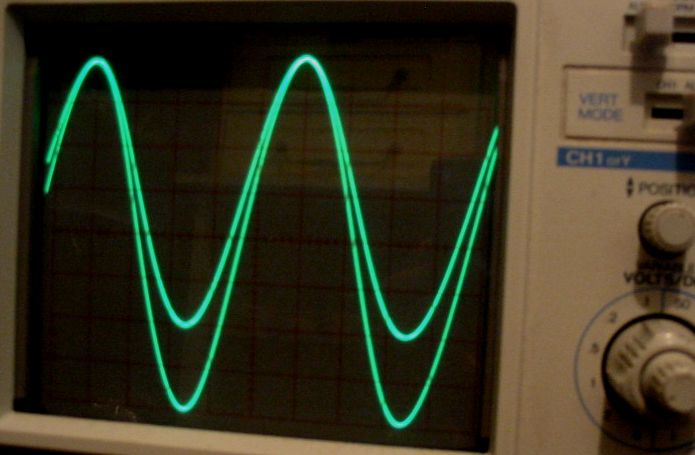

The only way one can use non matched ldr's is to have some way of constantly measuring the resistance in real time while playing music through the them, (because as with all cd's/tracks we want different levels of volume), this in itself is a problem of added corruptions from microprocessor or any other type of resistance monitoring devices.
The only thing in the signal path is one resistor when built with a matched sets of NSL32SR2S ldr's as set out from the start of this thread. This is what/why the Lightspeed Attenuator is all about.

or , at least - present these tests of yours , where you measured F. anomalies in LDR attenuators .
i've said: channel imbalance on certain frequencies as a consequence of silonex LDR nature. can't match them across the whole spectrum. impossible. no way. nada. you do it at a selected points and what about the rest?
however no need to spoil george's thread. if anyone is interested in, we can carry on at some other thread - if we get it here at all.
