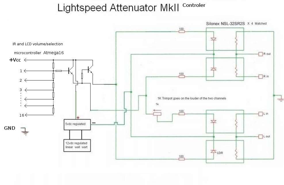

What I am working on ..
Why discrete R/2R DAC and not PWM control for LDR ?
Because PWM puts a lot of noise on LDR !
I am wondering if 8 bits aka 256 position is enough ?
So first try with 16bits aka 65536 position (which I think is tooo much ).
why use matched LDRs?What I am working on ..
just use different steps sent to each LED to achieve perfect balance all the way through the whole attenuation range.
and then use different steps to actually change the balance.
Store the required steps in a look up table.
Ok your idea for new construction ,
but my work is to make for already build Lightspeed attenuator a way of controlling by IR and add-on for source selection by replacing the poti for volume changing only .
Never the less I have also this idea of using not matched LDR and a routine for calibrating the two channel first time and store into a lookup table , so even a balance is possible to implement.
