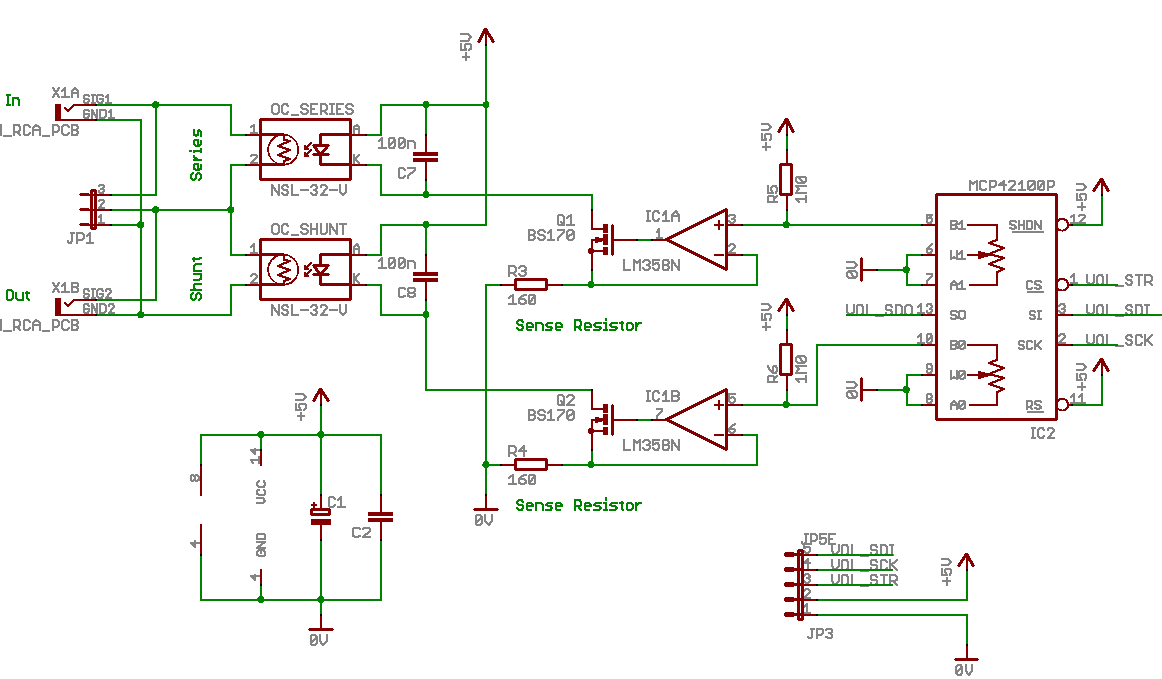

Here is the circuit I have been using with MCP42100.
I found this on the internet, but havn't been able to re-locate it since. All I know is that it's a current regulator by Mike Mladejovsky.
Using the attached spreadsheet (borrowed from the JT thread IIRC), I calculate the ADC values I need to read to acheive the required taper.
The arduino calibration program then goes through trying different permutations of series/shunt to get these readings.
The program is a work-in-progress and somewhat messy, but is a reasonable starting point.
Feel free to use/critique/improve
Mike

This is similar to this circuit:
Voltage Controlled Current Source - Current Servo
Look at my earlier post
This is what I was thinking about few days ago with PGA231X, but when I read about temperature drifts and accuracy as well as the starting point of 0.1 mA I thought I should ask for the VCCS and Maximus replied with his schematics. Try it and let us know what results you get, I use AVR too, if you need help on codes I am here. Also why do u want to read the ADC?

yes, that circuit is the same, I must have missed your earlier post.
The program I posted is the calibration one used to determine the best settings for a particular pair of opto-couplers.
The ADC is being used to determine the attenuation that a particular series/shunt setting on the digital-pot will give.
I put 5v across the opto-couplers and read the resultant voltage.
The final goal is to get a pair of arrays like this:
static const byte volume_series[127] = {46, 30, 22, 18, 14, 12, 11, 9, 8, 74, etc.. };
static const byte volume_shunt[127] = {1, 2, 1, 1, 2, 1, 1, 1, 1, 2, etc.. };
Then in the actual pre-amp, when setting a volume, you would use something like this (single channel):
current_volume++;
spi_out(cmd_pot_series, volume_series[current_volume]);
spi_out(cmd_pot_shunt, volume_shunt[current_volume]);
obviously, you can use smaller arrays if required.
Using the spreadsheet, I have calculated a series of ADC values I need to get to achieve the desired taper.
The spreadsheet (some columns hidden) shows the optimum attenuation (dB) and then the equivalent ADC value needed.
The Blue line on the graph shows the optimum, the red line the achieved and the yellow shows the deviation (not too good at low volumes).
Hope this explains better where I'm trying to get.
I'll let you know how I get on.....

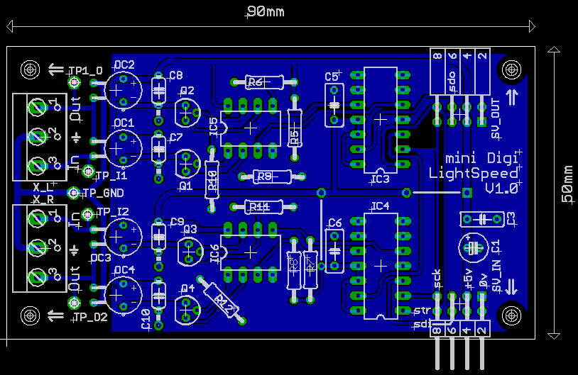

Anyway, I have decided to push on and am doing my own home-made layout as per the attachment.
