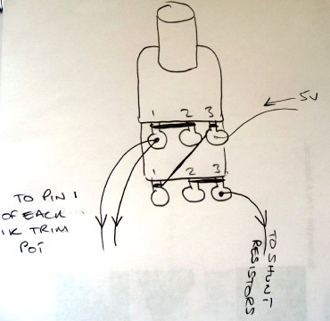

OK, I soldered a spare LDR to a 47k resistor wired in series with the 5v supply and I am getting a reading of 1K5
The test needs to be on the ones in your circuit. One of the 4 looks backward by the way.
Did you test to match these guys before putting them in the circuit so you could know what pot to use? You might possibly have a 4k pot here which might not be best for your system.

I wanted to check a random LDR out of the circuit to see what value it was.
The LDR isn't backward, this one has SR3 printed on both sides where as the others have SR3 on one side and 309 on the other. The dot is on the right side.
I have just checked the first LDR and its 1.567K, i'll now check the other three
When you are done with that then turn your Lightspeed off. DMM goes to first gang or second gang of your pot. Turn it to 47k. Now turn on LSA and measure associated LDRs. You wont probably get anywhere near the same reading because when you turn on the LSA the voltage drop across the LDRs will send their resistance higher, but anyway at least make sure their resistance is higher than what you measured them at.

First Test
1=1.567K
2=0
3=1.390K
4=0
Second Test (Pot set to 47K)
1=3.69K
2=0
3=3.5K
4=0
I am going to assume that 2 and 4 are your shunt resistors and that 0 means no reading. See the shunt go to ground and when full signal passes ground some of the signal is tempted to go to ground rather than to your amp. If the resistor is off then there is nothing enticing about going to ground so full signal continues on to your amp.
When series is high and shunt is low then volume is low and the reverse is true.
I dont know why your shunt are either dead or not lighting up.
You assume correctly!

I can see you have wired pot as pr original schematic
Do you rely on the numbering being right, or have you measured your pot
I would disconnect the pot, and measure it
Hi Tinitus
I think the pot is correct because I am using the same as Puffin, but that's no guarantee
Tyco Pot
http://uk.farnell.com/jsp/search/productdetail.jsp?SKU=1173987
Richard
I dont see any power going to positive pins of LDR 1 and 3.
Uriah
I have soldered pin 2 to 3 on the 1K trim pot
I hopes this helps
Richard
edit: I have just noticed the white lines to the 1k pot has moved slightly to the left and right. The white wire from pin 1 of the 100k pot connects to pin 1 of the 1k trim
