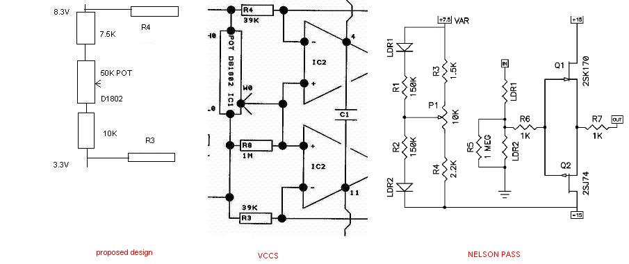

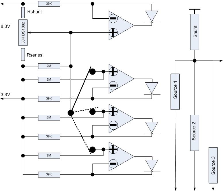

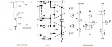

Per latest VCCS design (post#2143), in order to simulate Nelson Pass's design (post# 1362) of 40db POT , should we add another two resistors in serial with the D1802 POT ?
Can anyone recommend the resistor to fit SR2 design since the design was based on SR3?
Maximus, I guess your 39K value for R1-R4 is calculated as 150k * 5V / (7.5V + 15V -3V).

I chose 39K for the VCCS current range setting to roughly emulate the range Nelson Pass felt was optimal for the Silonex LDRs. It worked fine in my system so I left it in. My system is not a standard setup of equipment as there is no need for voltage gain in my line preamp or my power amps. If you want to operate the LDRs over a different range to match your system to your requirements, you can change the values of the current setting resistors. The LF 347 chip that drives the LDR LEDs should be good for up to 15ma of drive current without losing control. To stay within the LF347 output current range do not reduce the resistor value below 330R. You may have to reduce the value of R10 slightly to accomodate the additional load current. R2 and R4 control the shunt LDRs and R1 and R3 control the series LDRs.
