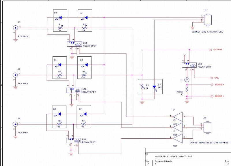

Can anybody tell me why there are 2 series LDRs in each source input rather than one?
Edit: Maybe this is a question for AndyPairo & apologies if this has been answered already (I've searched). Could you also give us an update on the "Italian Job"?
I have not built this multi input version that someone posted, but I believe at a quick glance it's so the output of the source (cd player) doesn't get shorted directly to ground and blow it up when the relay mutes that input to ground, as it still has the first ldr unpowered (1megohm resiatance approx) between the sources output and the earth shorted relay.
Cheers George
