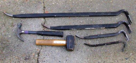

Grumpy_Git said:
If he pulls out now we won't be able to criticise his work.... :D
I have his address. ;)
