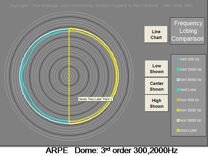

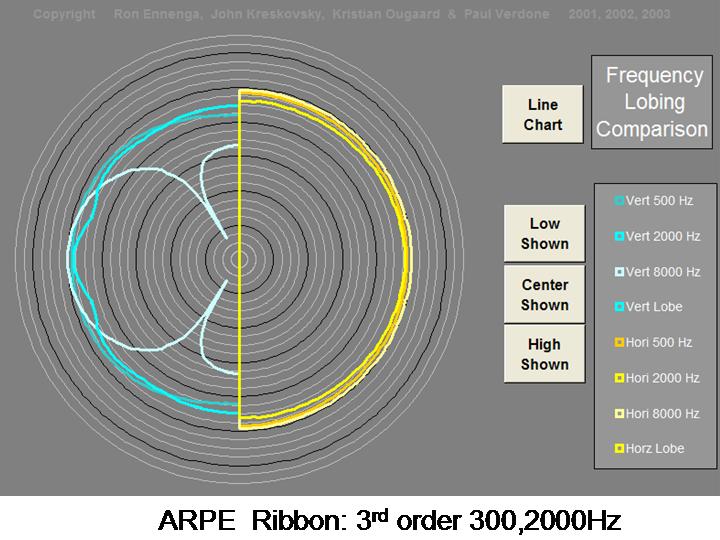

Getting past the "are ribbons the best" argument (a big step for me!), I'd like to add a caution to the mixed box/OB suggestions. I've never built one due to the difficulties optimizing them reported by others such as Tony Gee and his Modulus (ribbon & OB mid & sealed woofer - see http://www.humblehomemadehifi.com/Modulus.html). In the 6Moons review of the Bastanis Prometheus Mk II they also note set-up problems (http://www.6moons.com/audioreviews/bastanis/prometheus.html).
I've built a number of fullrange, TQWT boxes, several BR and sealed designs, and most recently, two OBs. I think the sound from the OBs are the best I've heard (and, of course, they are remarkably easy to build!). But OBs, as ScottG points out, need to be pulled out from the wall. In my living room they really need to be at least 1.0 m out. I would also agree with what I think ScottG is suggesting -- OBs function best if the bass is OB and the midrange+tweeter aren't.
To me the most interesting combination to experiment with would be OB bass and cardioid mid-high.
APRE tool 8" + 5" + ribbon WMTMW
300, 2000, 3rd order
time aligned baffle offsets
