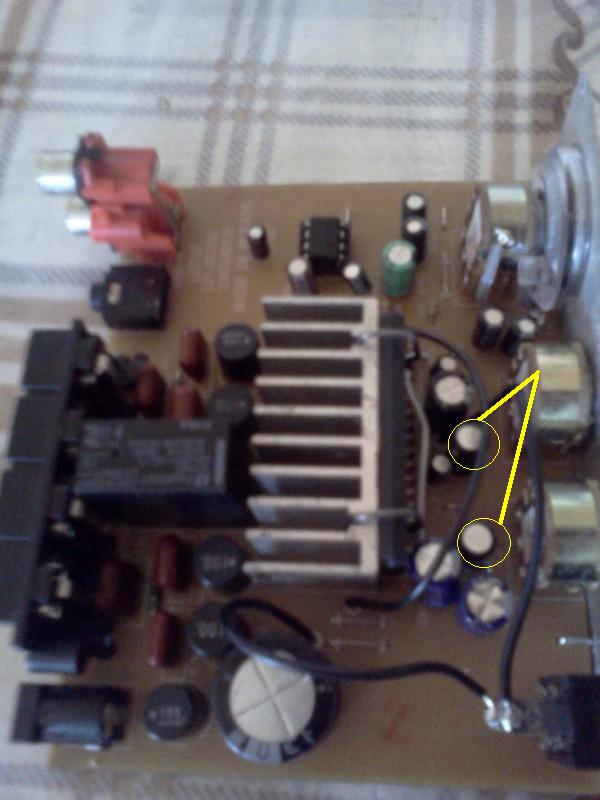

Try to give audio signal directly after the pre amp stage to the right pin of C20 & C21 as mentioned here : http://www.diyaudio.com/forums/class-d/90500-lepai-t-amp-ta2020-98.html by using a 2.2uf capacitor in series. This way you can see if the Lepai works as a power amp. If it works then the pre stage op amps are dead. Opamps die easily if short circuit their output.
Thanks you very much for your reply.. However I'm unable to find c20 , c21 inside this board..attached below are the pictures of the board..please help me to find those 2 capacitors..could you please elaborate more about this procedure (more detail).. Thank you

Well your board is a previous version than mine but easier to work with. The capacitors must be the ones in the yellow circle. Take them off and connect your input signal to the right pin from the upper side of the board. Directions are here ---> http://www.diyaudio.com/forums/class-d/90500-lepai-t-amp-ta2020-98.html .

According to the ta2020 datasheet pin 10 & 13 are designated as input pins..shall i input the signal to these pins with a 2.2 uf cap?
what side should be connected to the audio signal (+ or - side) ?
do i need to remove other parts (such as preamp etc..) in order to continue this test ?
Yes you can go directly. No need to remove anything for now.

No, just desolder the caps that he have circled (you can desolder them and use as they are 2.2uf), and input signal to the amp in the point you have desoldered the caps (will be two spots on each cap, you should input the + side of the audio signal through the cap and to the point that is near the TA2020 chip).

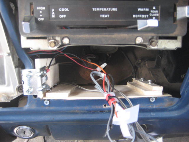

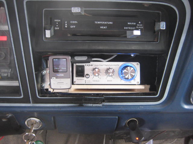

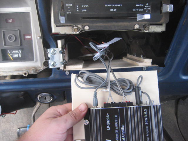

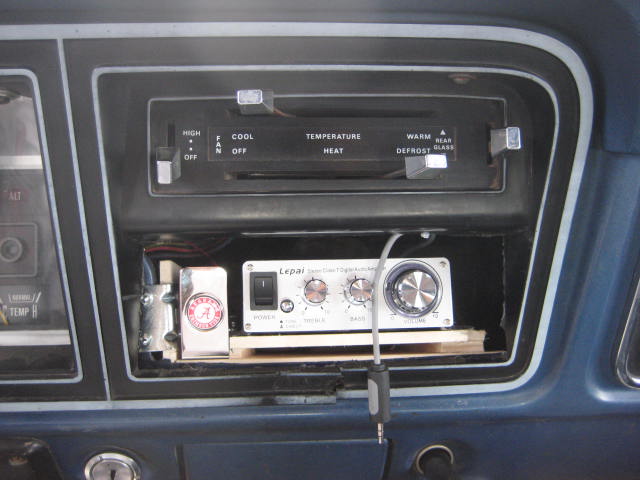

In Dash In Stall... and a few updates.
Ok, so I got tired (pretty quick) of reaching back behind the seat and turning on the inverter, then the amp, then the MP3 player... and went ahead with the in dash. It's not finished out yet, but a huge improvement to the old 10 pound head unit just flopping around in the dash. Having the volume right there on the dash is very handy, and I like the treb/bass adjusters too.
Labled and yanked all the old radio stuff out, left the power cords to use. Once I removed the bezel I had plenty of room to work with. I used a main frame platform (that will stay in the dash), and a carrier/prototype platform (that is just temporary and easy to slide in and out if needed)
Basically, I created the main platform out of the cheapest, thinest wood that lowes had (about 1/2" x 8" by 4') for $5. I made it out of wood because it's easier (for me) to work with, cheap, lightweight. Got some L brackets and wood screws and back to the house. I used one L bracket to mount on the fron left metal frame pillar, and the other two to hold the side board to the bottom board. So the main platform is just a bottom and the left side. You can see the small wood sliders/spacers that I put in. eventually, I would like to have it finished out nice with a wood faceplate, or a keylock cover. You can see that I used a money clip as a MP3 player (Sansa clip +) bracket. It is there so that the MP3 can clip to it and still remain by the radio. I would like to incorporate a small storage cubby hole to keep headphones/sd cards, ect. later on too if possible.
For wiring, I found a PS connector and wired to ground and +5amp fuse with key on (again, these wires were already ran, so why not use them).

I've already tried all the methods you mentioned earlier.
1. input audio signal to the two 2.2 uf caps as shown in the picture
(I've already remove pr-amp before this test). result- failed
2. disconnect pin no 18 & disconnect 4 diodes as shown in the picture
result -failed
what should i do now ? your help is highly appreciated.
I'm in the same situation.
If you have a multimeter, try to check the following pins FAULT (18), OVERLOADB(6), MUTE (11) and SLEEP (17). Only the OVERLOADB should have 5V, the others should be near 0V.
Also check that the voltages and grounds are ok, check the pins on the datasheet http://www.e-ele.net/DataSheet/TA2020.pdf
Btw on my amp, everything is correct but I have the OVERLOADB = 0V, so indicates that something is overloading the amp, but no sound output, the outputs have 6.8V. I have desoldered the chip, and checked the rest of the circuit, but everything seems to be ok so probably my chip is damaged... will try a new one when it arrives and comment results.
Did you guys checked the power supply ? From my experience some power supplies rated 12V will refuse to feed the lytics while others very feather weight rated 10v just did the job. I had several 12v that did put my lepais on dimmind lights with the relay not turnning on and arjen ta2020 in overload state.
Good luck
Good luck
Just checked all the connections...
These are the results..
fault pin 18 - 5v (already disconnected from rest of the circuit)
overload pin 6 - 0v
mute 11 - 0v
sleep 7 -0v
Any Idea about my next step? very confused at the moment .. Thanks
Well, you have the chip in Fault mode, check if exist any shortcircuit (between the outputs), and also check voltage for the power input pins (25 should be +12v, and 2 should be +5v).
