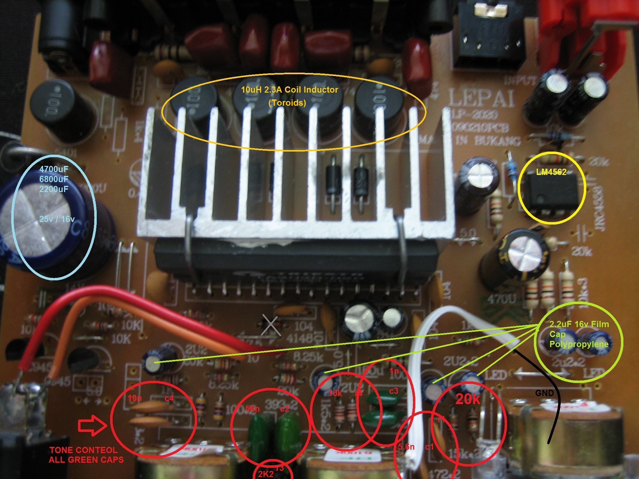

Completed Modifications
Update to my previous post (#518, Pg 52)...
g) changed tone circuit capacitors (with 1nF, 10nF, 5.6nF and 56nF / 5% bought off eBay) and resistors (20k, 2k2, 10k metal film 0.4W/0.1%) as per post #484, Pg49. Also replaced 430R (marked 100R *2) with wire links.
h) changed pots: volume (50k Dual Log RS 249-9288), bass & treble (100k Dual Log Rapid Electronics 65-1466).
i) still to do (have the diodes 1N5817).
j) changed inductors for 10uH/2.8A (RS 233-5134).
Also changed 1k5 resistor in series with blue LED for 4k3 (an arbitary decison) but led still seems bright! Need to see it in the normal evening low-light viewing conditions. Probably need to measure VOPA voltage and chose value to halve current through LED.
Issues:
1. original control knobs did finally come off with (not so) gentle prising but one tone control spindle broke from the slider inside the pot.
2. The new cermet tone control pots had a larger screw thread so had to enlarge the holes on the faceplate. They also sit slightly forward of original ones which means front faceplate now has slight bow in it (about 1-2mm).
3. Had to drill small hole in plastic see-through bezel (around volume control) to take the small metal positioning lug on the new pot. However, because tone pots were slightly forward, was unable to fully tighten fixing screw on volume pot so the positioning lug does not need to mate with new hole!
4. The original plastic control knobs have longitudinal flutting to secure them to the old pots (which are also flutted). However the new pots had plain spindles. Therefore decided to replace control knobs with some aluminium ones I already had in my spares box.
Must say can really notice the difference on initial listening. Much crisper sound and tone controls definately perform better. Well worth the effort!

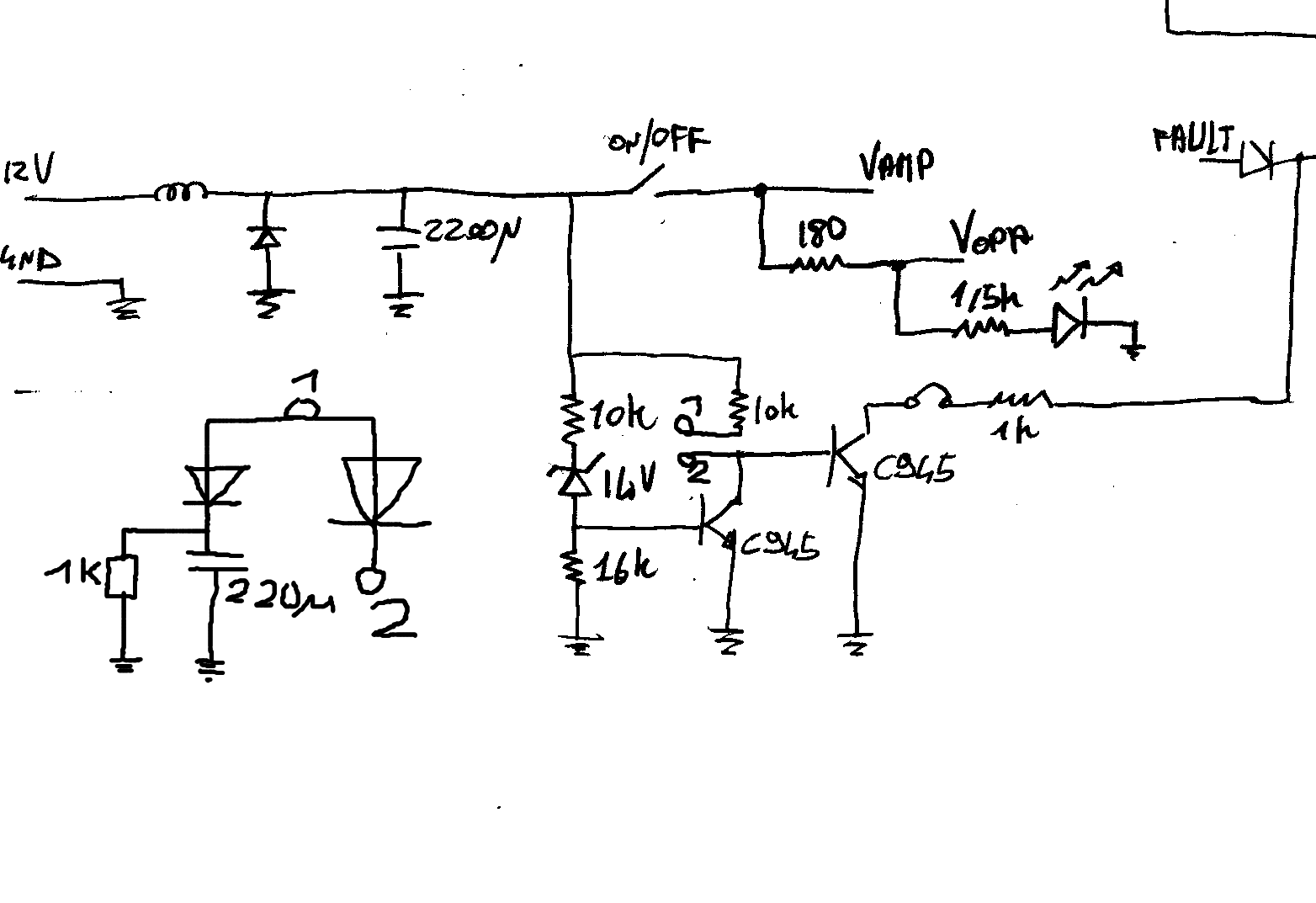

Hello
I'm new to the forum. At first I beg your pardon for my english.
I have bought an Lepai TA2020 and now I would like to pimp it.
I have read something about the bias. I measure 0,1 and 0,2V bias. I think that is OK but for interest reason how can I calibrate it?
The power on plop ist very disturbing and I think that my speakers don't like it.
I figured out an easy way to build a delay.
You need only 2x4148, 1x220uF, 1x1k
I attach my drawing with mod.
In LTSpice it works fine.
