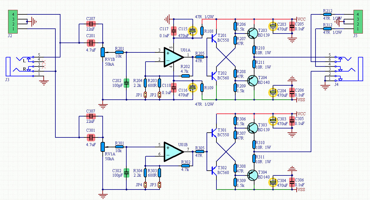

Lehmann headphone amp clone on aliexpress

My Lehmann Clone Finally Just Went into the Trash Where it Belongs!
This thread made me pull my Lehmann clone, which was built upon a blue PCB a few years ago, from a stack of projects that I had thrown over in the corner for trash in the near future.
After blowing the dust off it and connecting it to my recently purchased Niles SI-2100 Class D power amplifier, I was instantly greeted by some low-level hum with the volume all the way down.:mad:
So I did the ground rerouting as suggested in this post thinking it may be a ground loop:
http://www.diyaudio.com/forums/head...z-hum-lehmann-linear-clone-2.html#post4267890
The ground rerouting in that post was a total waste of time and didn't make any difference with the low level hum, so I tried connecting all input and output grounds to the same point on the signal ground(op-amp) side of the board.
Still...there was low level hum, so I concluded that the LM317/337 on-board PS wasn't up to the job of keeping the hum(or ripple) out of the super-duper discreet "diamond buffer" section of this design.
Just for kicks...I tried this Lehmann clone with my plasma TV and cable box hoping for the best.
As soon as I turned the TV on, there was even more hum and other crazy noises amplified by this POS Lehmann clone to the point it was unlistenable.
It was at this point...I disconnected my Lehmann clone and threw straight it in the trash where I should have thrown it several years ago.:D
This got me thinking, so I tried my simple LM317/337 PS with Calvin's discrete buffer and experienced the same type of low level hum even though it only has a theoretically gain of one.
Switching over to my clone of Salas' DCSTB cap multiplier PS resulted in ZERO hum with Calvin's buffer, though I didn't waste my time lowering the voltage to see if it would lower the low level hum problem with the Lehmann clone.
So...there are 2 things that should be learned here ladies and gentlemen::D
1. Don't waste your time and money on these "Lehmann Clone" kits with a on-board LM317/337 PS from eBay and Aliexpress unless you like a little 60 or 100 Hz "hum" to go along with your lower-level musical enjoyment. I don't but you may!:D
2. Don't even think about using a LM317/337 PS with a discrete amplifier design. These old regulators just aren't up to the job. Perhaps something that I should post over in the PS forums.

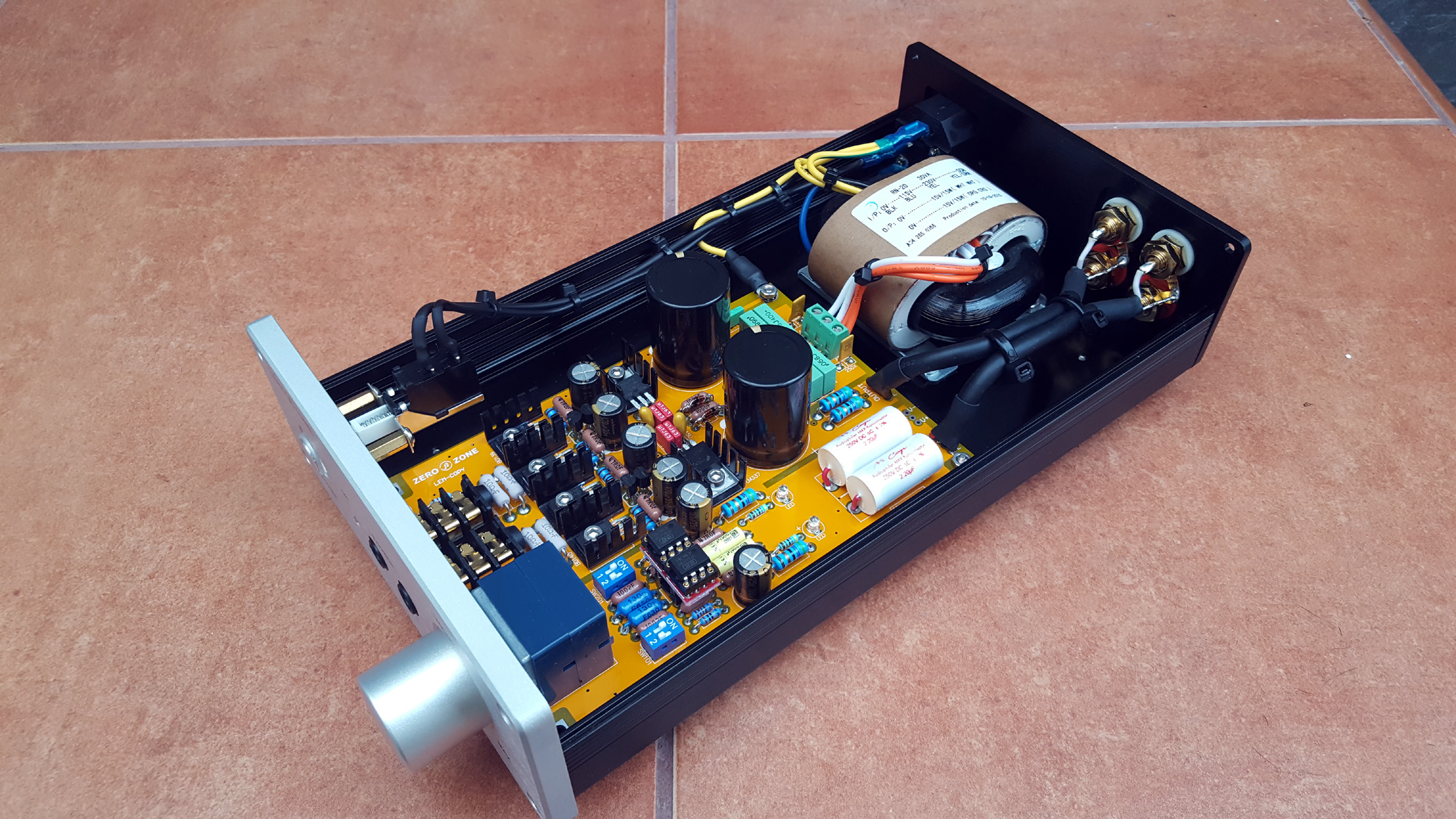

A couple of years ago I made one with good quality components and I matched all; sand, resistors... I did some mod on the PSU regulation and spent a lot of time experimenting with several caps and OPAs.
I had no problems with noise or hum.
It's an interesting amp to learn.

Well I bought a clone with all components but I got curiosity and finally I spent enough money to leave it to my linking.
Pcb is of a normal quality but if you abuse it you'll probably take off the pads.
I don't know what brand are the resistors but in my case they were at 1% and I used some in non-critical places.
Caps. I checked volt/cap and all is Ok but I wasn't sure and I decided to use originals brands and others series (Nichicon Muse and KW and Mundorf Mcap and Mlytic).
Sand... here I used original components also in the place of the ones that come with the kit.
Unfortunately, some places are famous for selling fake sand and caps.
I never did the amp with the kit components so I can't say how it sound but giving you some care and changing various details you can have a "decent" headphone amp.
