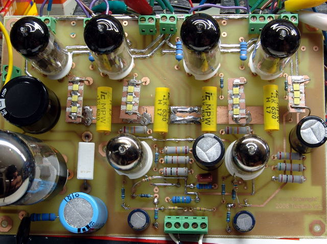

These camera phone flash SMD LED's have the lowest dynamic resistance of anything that I have tested, but I don't know what they are or where to get them. They came from a dumpster dive. They have more dynamics than the cap / resistor combo that it replaced.
Be aware that replacing the cap / resistor combo with LED's (or zeners, or other constant voltage circuits) essentially converts a cathode biased circuit to fixed bias. The grid resistors must be sized accordingly to avoid grid current induced runaway.

The first stage now has one yellow and one red LED in the cathode + MU stage..And it sounds very "Good" the Bass is more defined..I now have six LEDs and a diode under the board...
Worth the effort..Yes!
Would I take them out NO...you gotta be joking..LOL

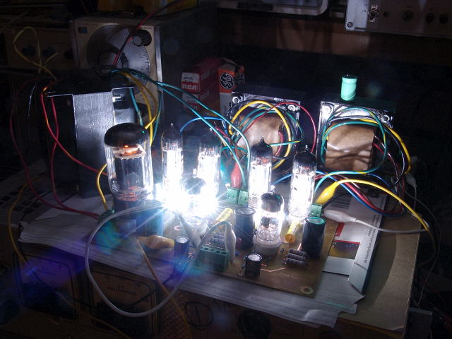

M Greg: OT question.
Are you sitting on a dinosaur and is Nibiru in the background ?
Don't you have your own Luck Dragon and wisdom pearl?
I thought we all had one..LOL
