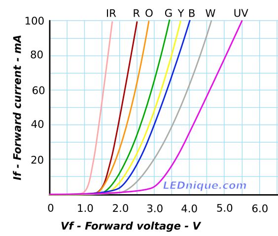

Regarding that graph showing LED Vf vs. If...
attachment.php
The Vf is related to the internal resistance of the LED at various points along the If/Vf curves. The internal resistance (let's call it Ri for now) stays pretty constantly low once there's more than 5mA of If. Below that, the LED's Ri goes up.
However in real life, using class A small-signal circuits, since the plate current of the tube stays constant, Vf of the LED stays fairly constant too. It's when you have wide fluctuations of current that the LED's Vf will vary widely in sympathy.
Taking a 12AX7, if the triode draws a constant 1mA plate current, that's what will be the LED's If as well. The Ri of the LED may be higher than it would be at If=5mA, but since the current going through it won't vary much at all, the Vf stays constant. So in the real world, tests have shown that using a cheap red LED to get about +1.6V at the cathode of a 12AX7 works fine.
See M. Blencouwe "Building High Fidelity Tube Preamps" pp. 244-46
