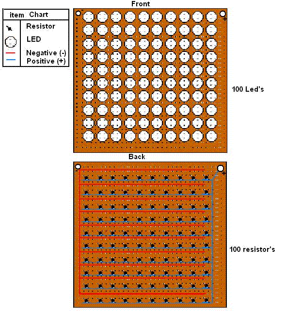

the spec sheet you linked to shows that each LED needs about 5V to work. You also need to limit the current to about 20mA. The 12Volt supply and a dropper resistor do that for you. But 100 of the LEDs needs 100 times the current and all that wasted power through 100 dropper resistors.
Put two LEDs in series. The pair now needs 10 Volts to operate. Limit the current to 20mA as before. However there is only 2volts to spare and a limiting resistor is going to be quite inaccurate trying to limit current with just 2Volts drop. Instead use an active current limiter. Set the current limiter to 20mA and supply two LEDs from it. Wasted power is reduced by about 75%. This allows a smaller power supply to be used, 1A instead of 2A.
So take your 100 LEDS and set up a series pair with a current limiter and do this fifty times.
Look up active constant current source. There you will find a two transistor + resistor circuit. Use that to supply the two LEDs.
There is a better way that combines the sources and saves on components and automatically controlls current to the operating LEDs if one goes dead on you.
I cannot recall who's application note it was featured in (maybe Nat Semi). Try that search I suggested.
here is an idea of what im doing i think 2a will be easyer and cheaper sence i have the led's and the 470ohm resistors and the 12vdc 2a already.
thats what i thought 3.5v not reverse volt like hes saying of 5v. iv been using that site i found it searching and a few others.
only thing i dont like about the site is it shows 1 resister to 2-3 leds im using 1 r to 1 led
