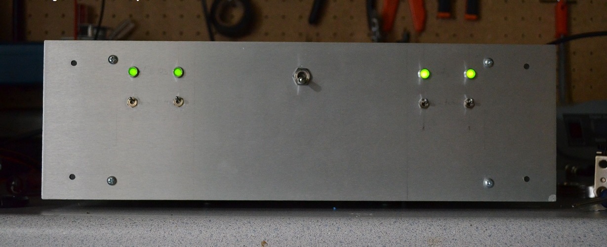

I made and LM3887 dual mono amp. I have been trying to find a good way to mount the LEDs, one for each power supplies, to the chassis. I have a bare face, just two 1/64" holes evenly spaced for each supply. The goal is to have the LED behind the hole but not right on top of it.
Any suggestions?

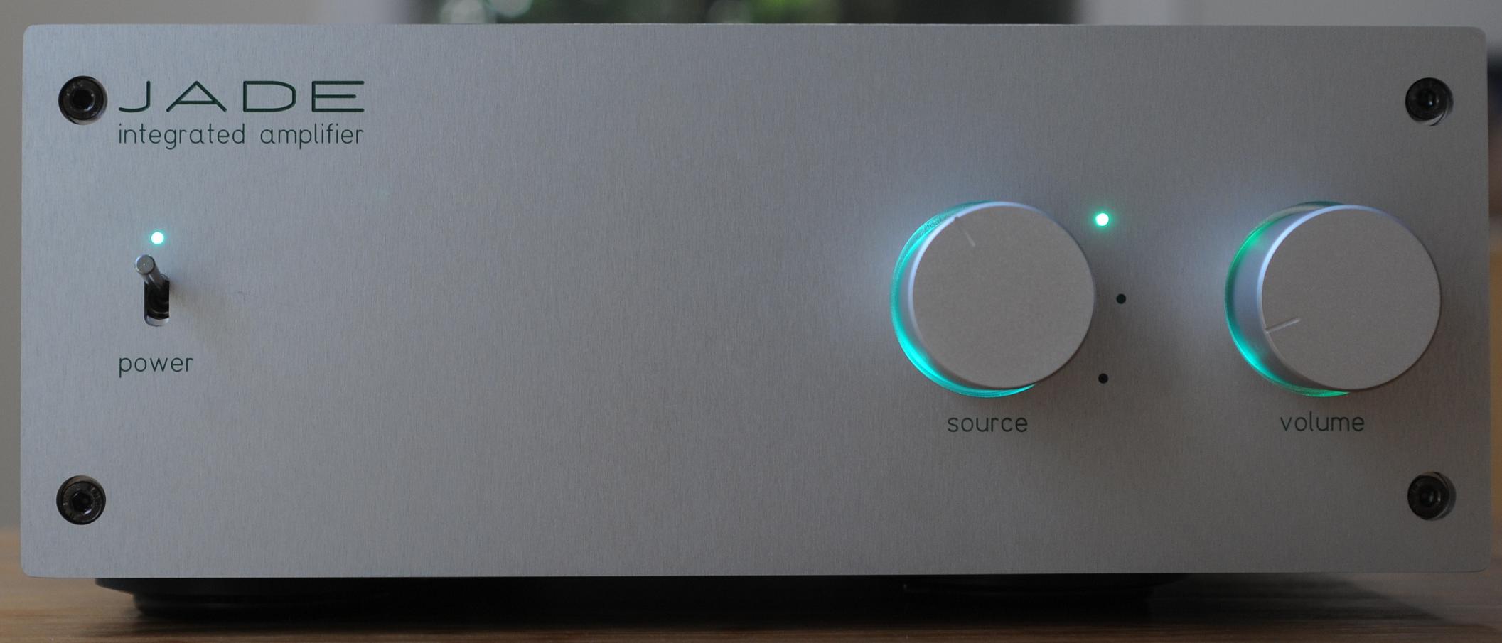

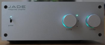

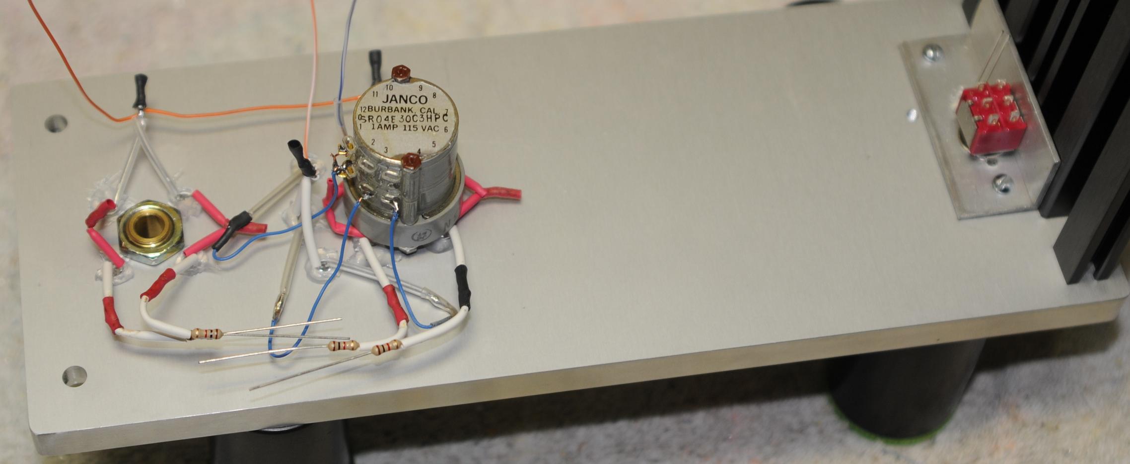

On several projects that involved HiFi2000 enclosures with 10mm front panels, I have drilled (or had Front Panel Express drill) a 3mm hole most, but not all, of the way through the panel from the rear face. On the front side, I have drilled a 1mm hole. Gluing a 3mm LED into the rear of the front panel is easy, and the small hole on the front is just large enough to be noticeable.
The photos show my daughter's LM3886 amp. There are LEDs mounted behind the knobs for backlighting and another above the switch.
