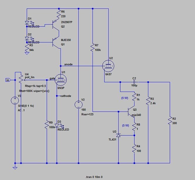

I mean to improve the Bottlehead, I wonder if can be the way for approaching the "speedball" (I don't have it)
If one does not have something on which they intend to improve, how would they verify the effects of their efforts?
You can throw out a few resistors and also reduce energy consumption a bit as you go. What's the supposed operating point of the 6AS7? Maybe I will sketch it up for you.
It should operate with Vc= -25/30 V and Ia = 35-40 mA. You can also send me MP, thanks a lot

Ok, I simmed it in spice but still don't get it. It is not a well balanced circuit in any way.What do you think about this?
Whats's the purpose of R1?
Whats's the purpose of R8?
You can build a better amp using just the 3 transistors and use the tubes for decoration only.
