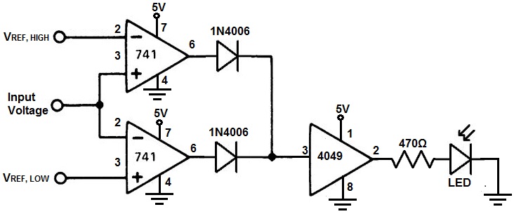

I found this circuit online....

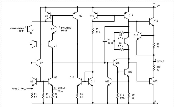

You would not use '741 because...
Smart modern people have forgot how to use '741
The Vos is a bit high for this application
The input stops working ~~2V above the negative supply rail (we want less)
You can hardly get a '741 today; the few left should be saved for people who need them
There are cheaper better modern parts

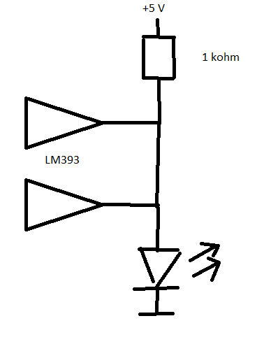

The LM339/LM393 is perfect. Costs pennies, current production (DIP may be old stock). Inputs go all the way to the negative rail. Output is open-collector which allows logic tricks.
The rig below shows red if too hot, turn-down now! Yellow if too cool, no panic, turn up for best sound. When right, it is dark, except signal peaks may flicker.

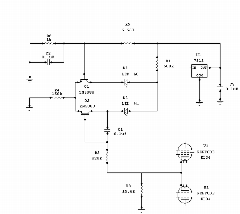

If we are having to set the fixed bias on tubes, don't we need to check them as the tube ages.
And if we have to set them to less negative as the tube ages, don't we have less max power from the amp, and potentially more distortion. Is it not just time to replace the tube(s)?
Self Bias requires a resistor (or current source) for each tube, and a bypass capacitor for each tube, unless we are cathode coupling with a current source. We can have a test point for each cathode, or for parallel cathodes.
This way, we can check the cathode voltage easily over time (unless we are too lazy).
It takes a $10 DMM.
You might even find it varies due to time of day, etc., according to the electric power delivered to your power outlet (unless everything is regulated, B+ and filaments).

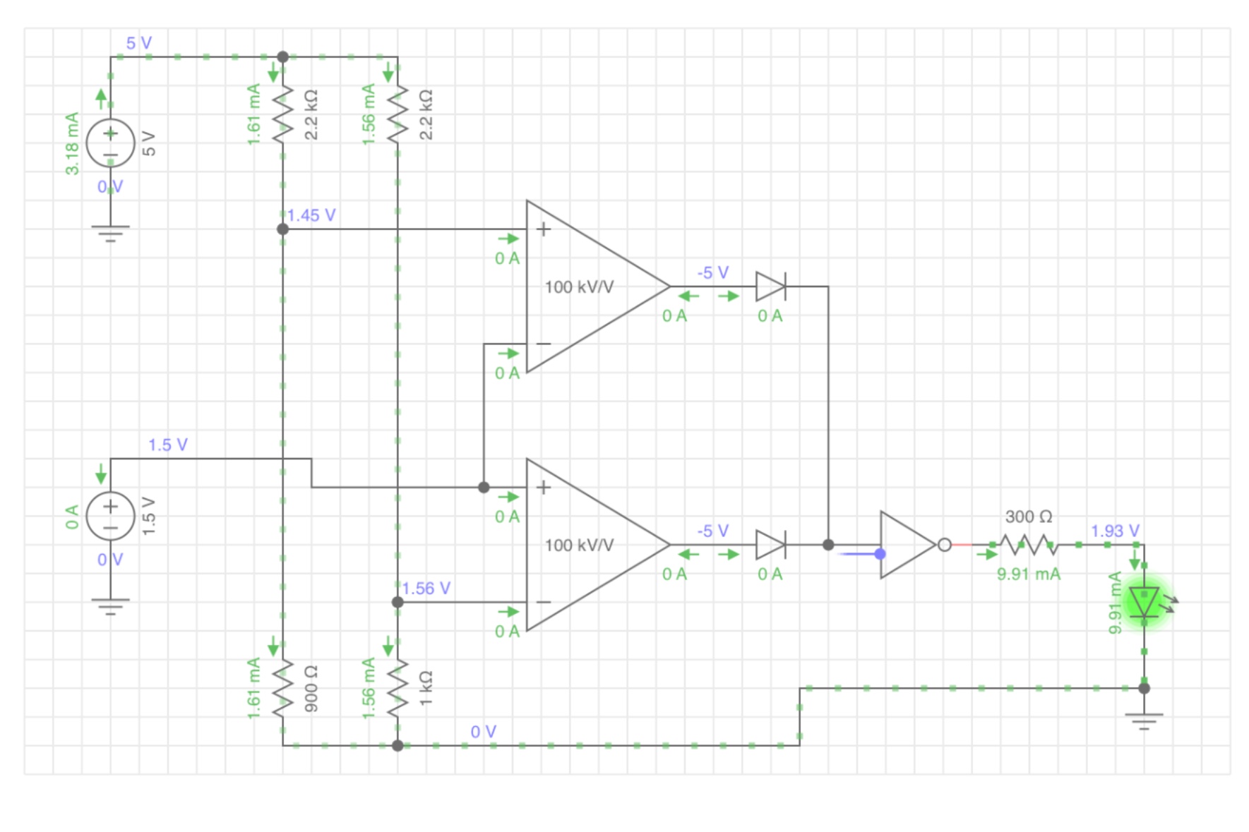

I’ve drawn up a circuit that works really well, it indicates low, high and balanced
Bias. There are two 10k pots that calibrate the window comparators, will have its own power supply, and can connect from a tap off heater winding.

Looks good! I see only a part of the schematic, but if I understand it correctly, Ref is the upper threshold and WV the lower. Depending on the supply voltage, R23 and R24 may have to be changed to stay below the LM339's maximum output current.
Yes, In the YouTube video I posted I was using a 5volt DC Power source,so I used 330R for the limiting resistor. The neat thing is even if the upper and lower window are very close together
Let’s say 650mV and 600mV are my window, the green LED doesn’t shut completely off but the High and Low LEDs are completely off when the target voltage is reached.

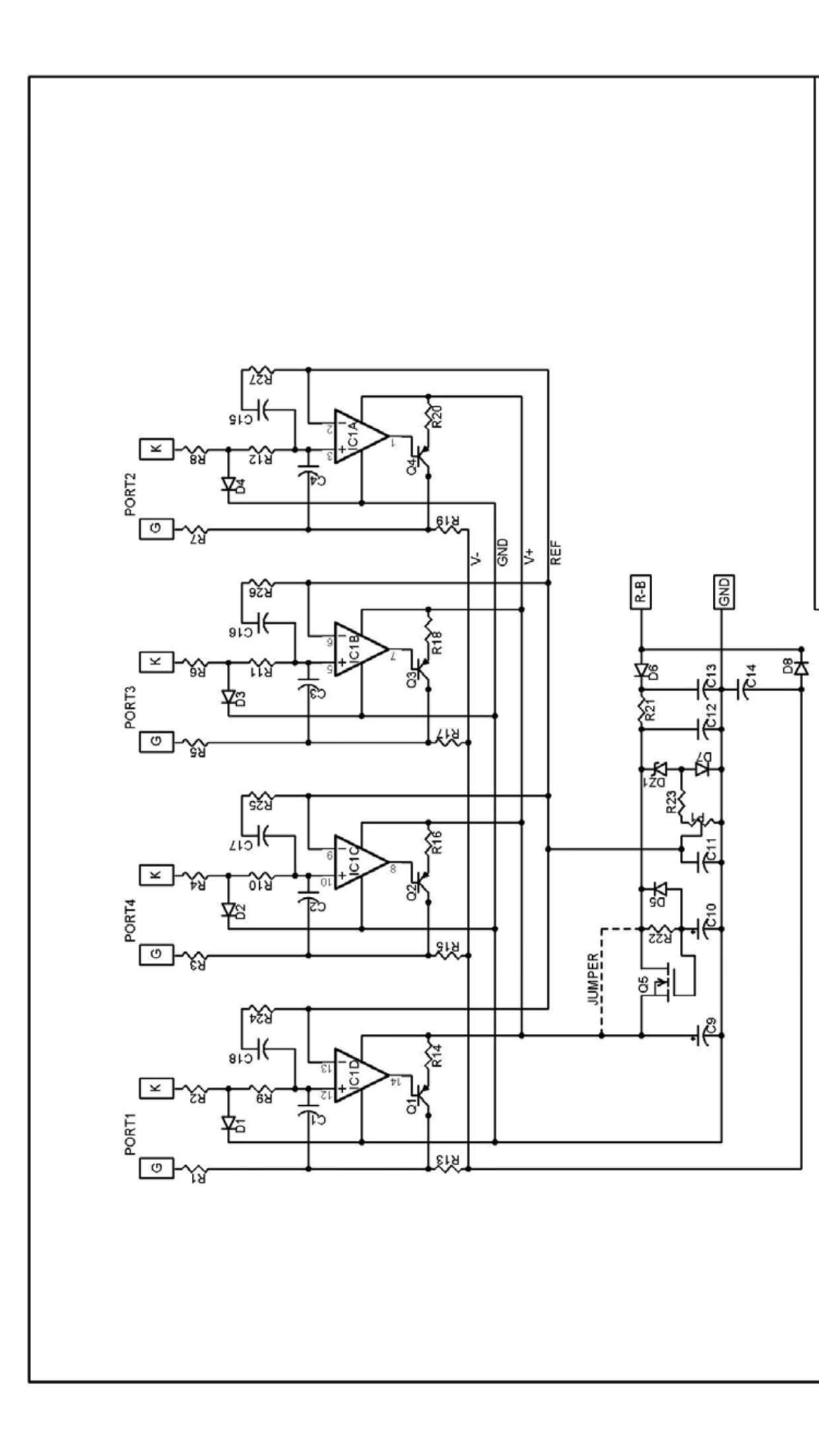

A design maybe using a micro controller instead of an opamp?
This is still a work in progress, there are a few changes in order, possibly changing the overvoltage protection, shunting the overvoltage to ground,instead B+?
