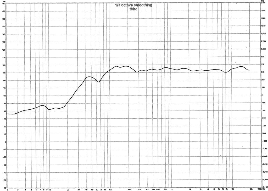

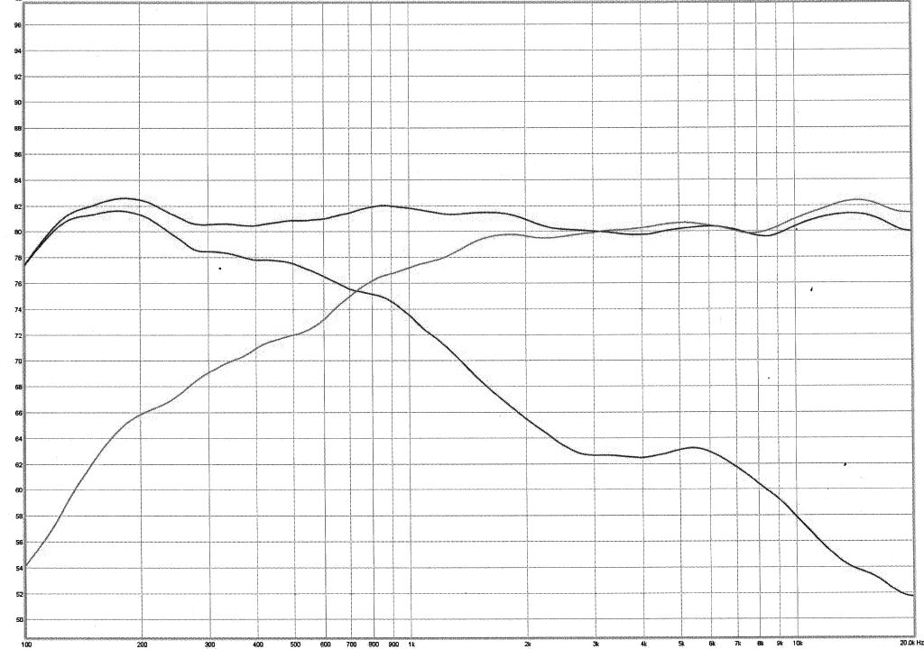

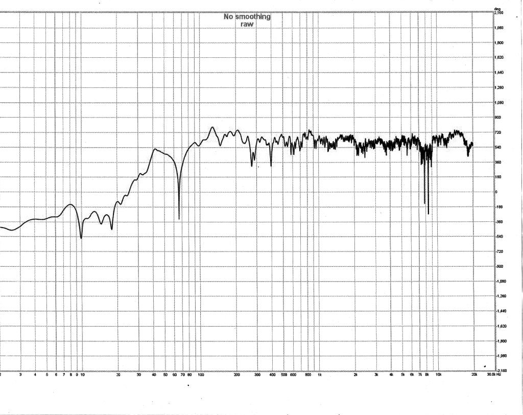

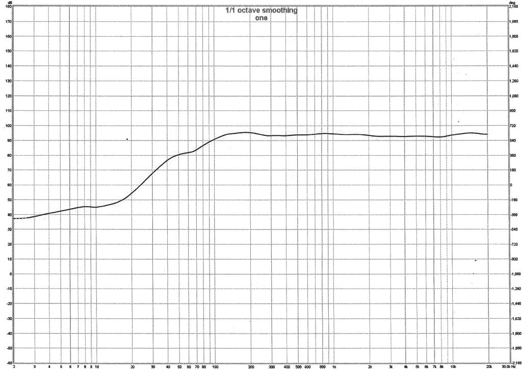

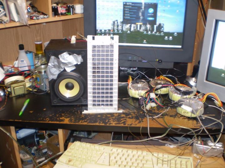

Here is some more info to help get you started,
Elektrostatic Loudspeakers
As Calvin mentioned, ESL's need not be big to get that Big Sound!!!
A Desktop ESL Build
A Segmented Stator Desktop ESL
I just found the Precision frequency plots of my little system the other day!!!
I have measured in excess of +105db with this little setup as the little woofer can't keep up much over 100db or so.
The plots are calibrated in db as well.
Enjoy!!!
jer :)
