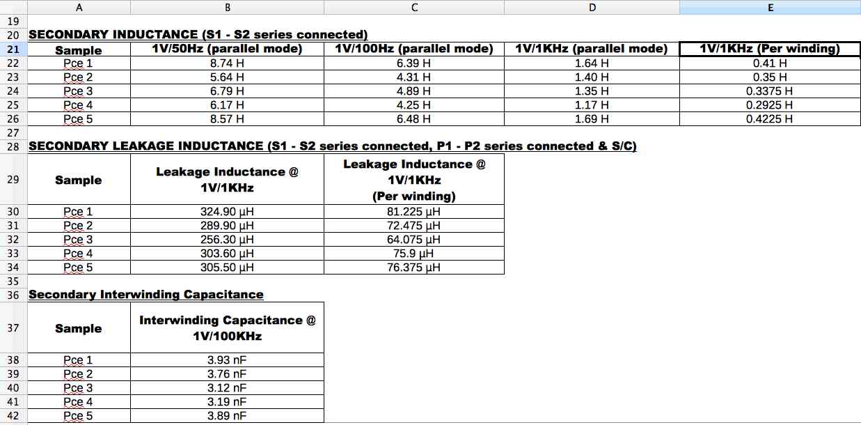

Hello everyone,
since my measurements seemed to be so random and I was quite unsure of myself or my methods, i wrote a letter to Talema to ask them if they would make some measurements for me.
See the attached file, its an excel sheet in open office format
Transformer is a Talema:
model: RKPT 25218, 25 VA
primaries: 2x 115v can be wired in series for 230v
secondaries: 2x 18v
Equipment used for the measurements:
Waynekerr 3260B
NOTE: the secondary measurements were made with the windings connected together in series, so one must divide those values by 4 to get a per winding value. I've done that for some of them, e.g. Sec. + Sec. Leakage Inductance. See also (Per Winding) caption.
My induction measurements of 0.07mH@3 kHz were "way" off compared to his. He measured 0.41H@1kHz or 410mH!?
Maybe for such transformers with 2x Primareis + 2x Secondaries, both Secondaries must be tied together in order to get correct measurements?
I will remeasure with both secondaries connected to see if my results are more comparable to his!

Sorry, guess it won't accept my file.:eek:
Here's a screen shot...
Chris

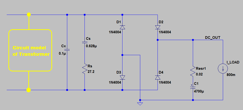

Can anyone familiar with Hagerman's snubber Paper verify the logic of my calculations here?
I'm a little confused about how to calculate the snubber capacitor Cs and the snubber resistor Rs, when using the "extra" Cx cap.
1. Rs = sqrt(Lt / Ceq),
where Lt = sec. leakage inductance. For my transformer, I'm using 74.01 uH
2. Ceq = Ct + Cd + Cx,
where Ct = sec. interwinding capacitance, Cd diode capacitance and Cx, snubber capacitor.
3. Cs = 2 * pie * sqrt(Lt * Ceq) / Rs
According to Hagerman, if Cx is much much larger than Ct + Cd, Ceq = Cx. For my Cx value of 0.1uF this should hold, since Cd is approx. 50 pF and Ct for my transformer is about 3578 pF
If i put in my values, i get this:
Rs = 27.20 ohms
Cs = 0.628 uF
Cx = 0.1 uF
So i would use Cx across the supply rails followed by Rs + Cs in series across the supply rails.

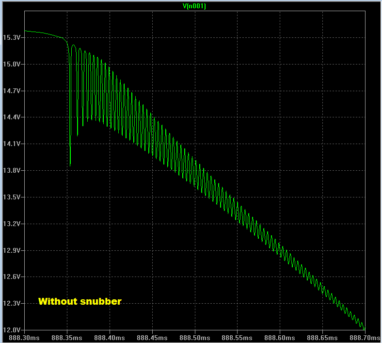

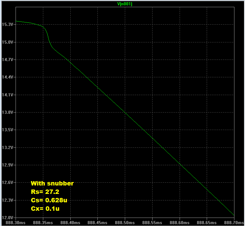

You could verify it yourself using LTSPICE. You could simulate the transformer + rectifier + filter + load, twice: once without the snubber, and again with the snubber. Then you could eyeball the waveforms and ask yourself, does this look OK?
Of course, simulations can fall victim to the garbage-in, garbage-out syndrome. If the circuit you simulate is incorrect, the simulation result will be incorrect too. In this case, if the transformer measurements were incorrect, or if you have interpreted the measurements incorrectly, or if you incorrectly translate them into a circuit model for simulation, then you've got garbage-in. You will naturally receive garbage-out.
I've attached a simulation schematic which shows one way you can test your snubber in LTSPICE. I deliberately left out the hard part -- interpreting the measurements and forming a simulation model -- so as not to rob you of the opportunity to learn by doing, and to learn more by doing-over. Fill in the yellow box and simulate. You may get results that match mine, which are also attached.
However, keep several points in mind: (1) the measured data might be WRONG. (2) your interpretation of the measured data might be WRONG. my interpretation might be wrong too. (3) when you convert the measured data into an LTSPICE simulation model, you might do that WRONG. so might I.
If any link in the chain is WRONG, from measurements, to interpretation of measurements, to circuit modeling; then you've given garbage-in to LTSPICE. You should expect garbage-out.
Also, don't neglect the possibility that I and others on this website may be agents of Satan, placed on earth to mislead you with falsehoods, half-truths, irrelevancies, and non sequitirs. Don't blindly trust everything you see on websites.

Looking at Hagerman's equivalent circuit, i would fill in your little yellow box with.
-an inductor with my leakage value
-a cap in series with it using my interwinding cap.
I will def. try that out.
Btw. your results with my snubber values look quite ok, assuming you modeled/ interp. everything correctly.

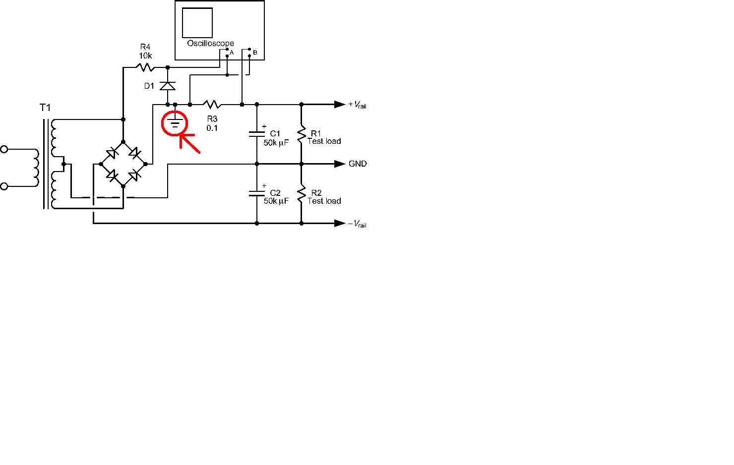

I would like to measure the ringing across my power supply diodes using the test setup proposed in Bob Cordell's Audio Amplifiers Book. For the test setup circuit, see the attached schematic.
Could anyone familiar with that method, explain to me what is meant by that earth connection, which i have circled.
If i were to connect it to GND, this would be directly shorting the positive rail and would end up cooking my diode(s).
Is this earth simply the earth on the pwr chord?

To measure the voltage across a component using a 'scope, it can be very convenient to ground one end of the component.
A PSU is normally grounded at the output end of the 0V rail. Provided the whole circuit is otherwise floating then, apart from stray capacitance issues, it can be grounded anywhere. Remember, the 0V rail is only 0V because someone decided to ground it. Apart from that, there is nothing 0V about it; it is merely Vrail above the 'negative' rail and Vrail below the 'positive' rail. Voltage always is a comparison between two points.
Joined 2011
This little test jig is adapted from Bob Cordell's Figure 16.10 on page 353. It lets me observe oscillatory ringing of the power transformer's secondary, and to observe the damping effects of the snubbing network (Rs, Cs, Cx) as I adjust Rs. I like to dial Rs until I get a damping factor (zeta) of approximately 0.8. Then I simply turn off the power, remove the (socketed) trimpot from the jig, and measure Rs on my ohmmeter. Snubber design for this transformer is now complete! Without performing a single inductance or capacitance measurement.
The snubber's parallel capacitor Cx swamps out the capacitance of the transformer secondary, plus the junction capacitance of any rectifier I could possibly select, so the transformer + snubber work together well in the final application, even with different layout and lead lengths. Even with different rectifiers.
I like to use extremely "slow" (long tRR) diodes in the jig; they seem to give the largest amplitude of oscillatory ringing and the longest duration of ringing.
Sharp eyed readers may note that I've modified the output network (R1, D5, D6) a little bit, compared to Bob Cordell's original. I'm using two low capacitance signal diodes instead of one high capacitance rectifier. I've also cut the resistance by 10X, to be less sensitive to fixture and probe capacitance. The good news is, you can simulate all of this in LTSPICE and customize the output network however YOU like.
To avoid overheating the 30 ohm, 50 watt load resistor, keep the transformer secondary voltage below { sqrt(30*50)/sqrt(2) } = 27.4 volts RMS. If your secondary voltage is higher, either feed the primary from a variac, or change to a different load resistor arrangement. Also be mindful of the filter capacitor voltage rating.
I chose this particular load value so I could measure an Antek AS3218, which is a 300VA toroid with two 18 volt secondaries. It runs the secondary at about 0.8 amps, plenty enough to get the diodes switching on and off hard, so they'll sing their RF tune.
In case anyone wondered, "Dprot" is supposed to protect the surprisingly expensive, high ripple-current, low ESR filter capacitor from reverse bias, in case I accidentally install one or more of the bridge diodes backwards. I'd rather blow the fuse than explode a large electrolytic capacitor.
