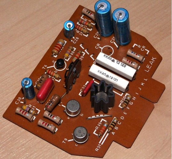

I've found top side but I still need copper side.
Here you go ..
Hmm......the Delta70 surfaces again. This morning I came across the board that I had made . As I said earlier it isn't a direct clone as it uses different transistors and resistor values and a few circuit modifications. It sounds nice but possibly not very 'accurate'. Newer designs are better at transients and have better bass control. However I must fire it up again and see how it sounds against what I am using today. Should be interesting.
That is TO5 package driver transistors. They don't make those anymore, and the pin compatible TO126 plastic package is also very rare. I've been using TO220 tranistors like TIP31C and TIP32C instead of TO5 transistors, but you have to twist the leads around because TO220 is B,C,E and TO126 is E-B-C.
The good news is that TO220 is easy to make a heat sink for, just cut a smidge of aluminum door frame and drill a hole in it. The tab is C, so don't let a heat sink touch anything, or use a mica insulator kit.
Ashok, the biggest sonic limitation on a Leak 70 was probably the original output transistors. Real 5 digit RCA transistors were selected from the 2N3055 process for more Vceo (or less leakage current at test voltage), but they had Ft of maybe 200 khz, which was probably audibly slow. I've used NTE60 output transistors instead, (on a copy of the Leak) which are probable MJ15003 copies, and the faster Ft cleans up the sound some IMHO. See the simulations someone did on Leak Stereo 70 with 2n3055, TIP3055, and something else.

This is helpful, but can the Leak Stereo 70 driver transistors be used in a Quad 303? It looks like the collector emitter voltage is OK, but I,m no expert.
