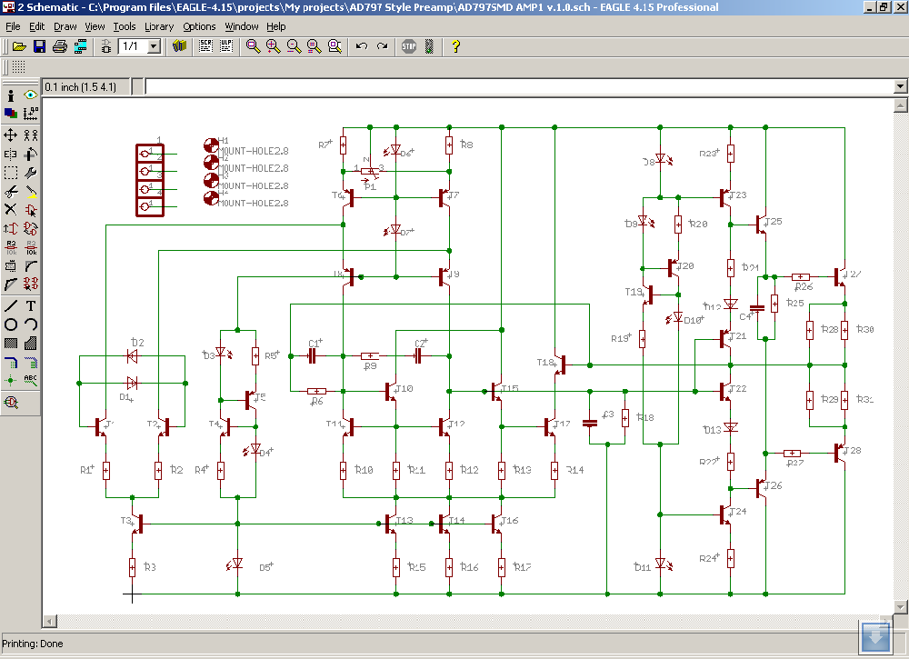

It's to soon for cigar and champagne, I am afraid...but thank you anyway. So far I am done with a layout in Eagle, just buying some extra time to look for mistakes or something that could be improved even further.

This is schematic of my discrete AD797 style opamp done with SMD devices...input RF filter and output filter are not there as I intend to use it as plug-in module instead of monolith dual opamps in my rig, hopefully :D
