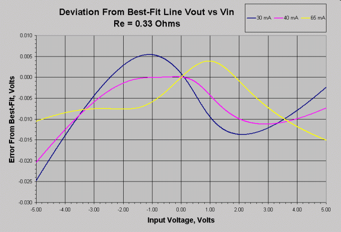

jam said:Andy,
Do you have any graphs that plot crossover distortion as a function of bias from a few mA to several amps?
This would help shed some light on the subject.
I have some plots at home of a few bias currents, but I stopped increasing the bias when the distortion started increasing (maybe 100 mA or so with 0.33 Ohm resistors). I'm at work now, but I'll see what I can dig up when I get home. It's a manual process with LTSpice, so it's very time consuming. I don't have one of those premium simulators that allow such things to be automated. Self has similar plots at his site, but his plots show the instantaneous slope of Vout vs Vin as a function of Vin rather than the deviation of the Vout-Vin curve from best-fit.

Okay, here's some stuff I dug up. One caution, this data was taken with the older On Semiconductor model for the MJL1302A before they updated it, so it won't be as accurate as their latest. I took the data before I realized the model had unrealistic max beta.
Anyhow, one thing that's interesting is the slope of the error from best-fit near zero volts out (I added an offset to the input so that I got zero Volts out for zero Volts in). If the error slope is positive, the incremental slope is greater than the best-fit. Likewise, if the slope of the error is negative, the incremental slope is less than the best-fit (underbias condition). So clearly 30 mA is underbiased, and 65 mA shows a gain increase near zero volts relative to the best-fit. But the overall error for 65 mA still looks pretty good. I'd like to see more curves of course. Maybe I'll look into how the simulation process can be made more automated, maybe with a swept parameter. I stopped increasing the bias current when the slope of the incremental error became positive near zeor volts
