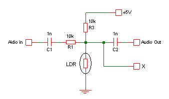

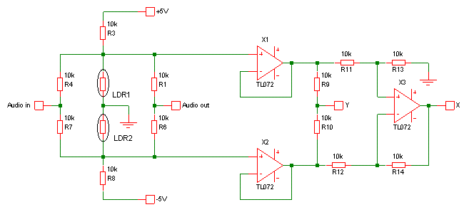

Below are a couple of "simplest possible" circuits that I'm thinking about to start with.
In the first one, the DC voltage at X is directly proportional to the gain (i.e. 1 / attenuation) of the circuit. For control purposes, it will either have to be filtered or compared with a reference and integrated. If an output buffer is used, that could be configured as a 2'nd order VCVS filter to minimize the VLF output when the user twiddles the volume knob.
In the second circuit, The DC voltage at X is also proportional to gain, but there will be minimal signal voltage imposed (if the DC offset is zero). The DC voltage at Y can be monitored (via an integrator) by a second servo to set the DC offset to zero.
I take back what I said about the servos being easy. One awkward bit is choosing time constants due to the LDRs having very different rise and fall times, both of which vary wildly with attenuation level.

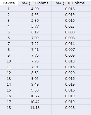

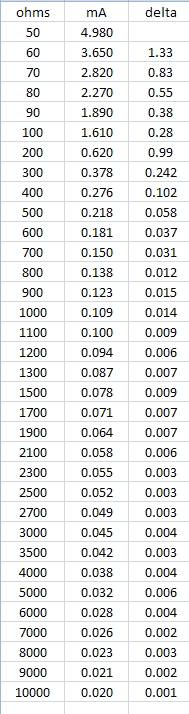

The devil is in the details. Have you played with LDRs? Some points to consider:
1. At higher resistances, it takes quite a while for resistance to completely stabilize. At high resistances, it can take a minute to completely stabilize and then it wanders around a central value +/- a few hundred ohms.
2. Whatever control mechanism you use, it must be capable of accurate control over a range of maybe 15ma at 40 ohms to .005ma at 10K. There is a wide range of sensitivities, I'll attach a list I compiled using my present current control arrangement. At the high end, a change of .001ma can change the resistance by 1K ohms down, or 10K ohms up (a range of 9K~20K). With some of these devices at 10K ohms, a slight change in current will make the unit act like it fell off the edge of the world, resistance-wise.
I believe that I've read that udailey has limited the upper end of his Lighter Note to 8k ohms to avoid the drop-off at 10K.
3. What measurable DC voltage will you use in a device whose resistance will vary across a range of 40 ohms to 10K ohms, always keeping in mind that power is limited to 50mW?

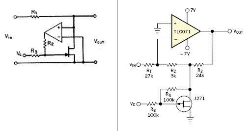

I wonder if one couldn't get better results using JFETS instead of LDRs as the variable resistance elements. Here's links to a couple of relevant documents:
http://www.eecg.toronto.edu/~kphang/papers/2001/martin_AGC.pdf
http://www.edn.com/contents/images/120601di.pdf
It should be easy to get just as much distortion as with the LDRs, for those that like that sort of thing. Ahem, let me rephrase that.... Those that like the sound of LDRs despite their distortion may also like the JFET version despite it's distortion.
Sample circuits below.
