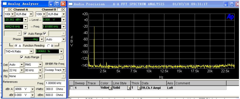

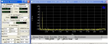

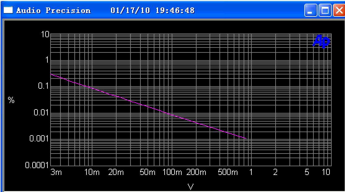

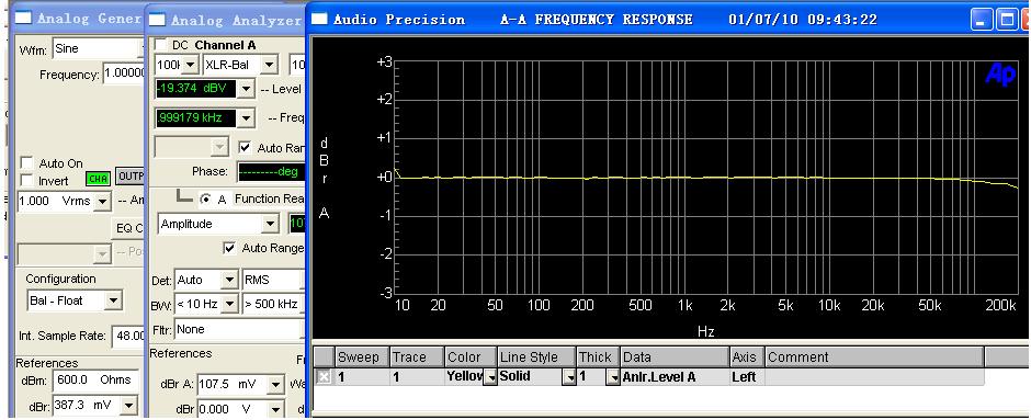

Hi buddy, R-2R can be configurate to log type too, but more steps is needed.
As I know, 65535 steps may be fine, 4096 steps is OK
with 65535 steps, I made 1dB/step attenuation
Maybe you can refer to my new VOL KIT ^_^
http://www.diyaudio.com/forums/swap-meet/163454-fs-ultimate-attenuator-kit-audio-balanced-single-end.html#post2124574
