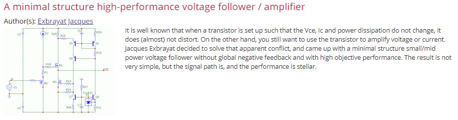

Power dissipation on gain transistor should be constant. If that is the case, both responses, with and without thermal model in example c.), are virtually the same. So introducing ..

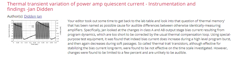

I looked at (measured) thermal modulation of bias in an output stage. I could measure it, but found it only a few % of the bias current, and on the distortion measurement I didn't see anything at all.

Similar set of measurements (with/without constant PD) performed on voltage gain device, like VAS transistor, would give quite more than only few percentages in THD differentiation (OLG mode) caused by thermal distortion. 0 dB voltage gain buffer is obviously more resistant to thermal distortions, especially in CLG mode, like your test case was.

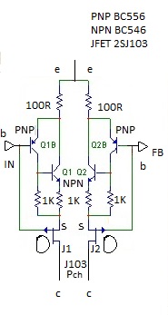

Catch me up -- seen several mentions here of a "Rush cascode" -- is there a diagram of that topology here somewhere??
Check this one, BC550 + BC560 makes a Rush.

I attach the diagram for the sub-circuit that I use to replace the input differential amplifier. I added another resistor which gave me negligible offset. I am no expert so you will probably make better decisions regarding position and value of the Rs. Feel free to advice.
