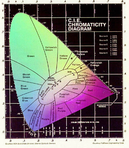

About color temperature: this is complicated and I'm just starting to learn, but I will do my best to learn by explaining. If I'm wrong about anything, please correct me! Most of this is derived from the Poynton Color FAQ (www.inforamp.net/~poynton).
Natural daylight (in northern Europe) has a spectral energy distribution that closely match black-body radiation at 6500 K. This is also called a D65 illuminant. This is a good "standard white".
Computer color screens usually have a higher color temperature, 9300 K (more blue). This is because the blue phosphors are more efficient than the red and green ones, so this is a compromise to get more light but at a less accurate color reproduction.
To understand the rest you first need an understanding of the CIE chromaticity diagram (attached below) and CIE XYZ "tristimulus values" (see the Color FAQ):
The 6500 K white point has CIE chromaticity coordinates (x, y) = (0.3127, 0.3290).
There has been an international agreement of what primaries to use for HDTV. These also closely match the primaries used in ordinary TVs and computer screens. The CIE xy coordinates of these primaries are R = (0.640, 0.330); G = (0.300, 0.600); B = (0.150, 0.060).
These primaries cannot be readily converted into pure laser wavelengths since the phosphors used in TV screens have a much broader spectrum than a laser, but approximately they are (R, G, B) = (607 nm, 557 nm, 465 nm).
If instead lasers are used with (R, G, B) = (635 nm, 532 nm, 473 nm), the corresponding CIE chromaticity coordinates are R = (0.714, 0.286), G = (0.170, 0.797); B = (0.116, 0.074). This gives a better color gamut (more possible colors) except for the deep blue end which is a little bit worse.
Now, how do we calculate the balance between the primaries needed to get D65 white? This is my guess, feel free to correct me if I've made a mistake, and please tell me if I'm doing it right also:
From the Color FAQ: "the color produced by any additive mixture of three primary spectra can be predicted by adding the corresponding fractions of the XYZ components of the primaries". Here we know the resulting color (D65 white) but we do not know the fractions of our primaries to get it. So, we look up the XYZ values (or convert the xy coordinates above to XYZ) of our primaries and the D65 point. We put this into an equation system and after some Gauss-Jordan elimination we get intensity of red = 1.60, intensity of green = 1.00, intensity of blue = 1.27.
I've got no idea if this is really correct but it does make sense: the human eye are most sensitive to green, and we have chosen a blue that is quite bright and therefore should be quite visible.
Well, hope this makes at least a little sense...
