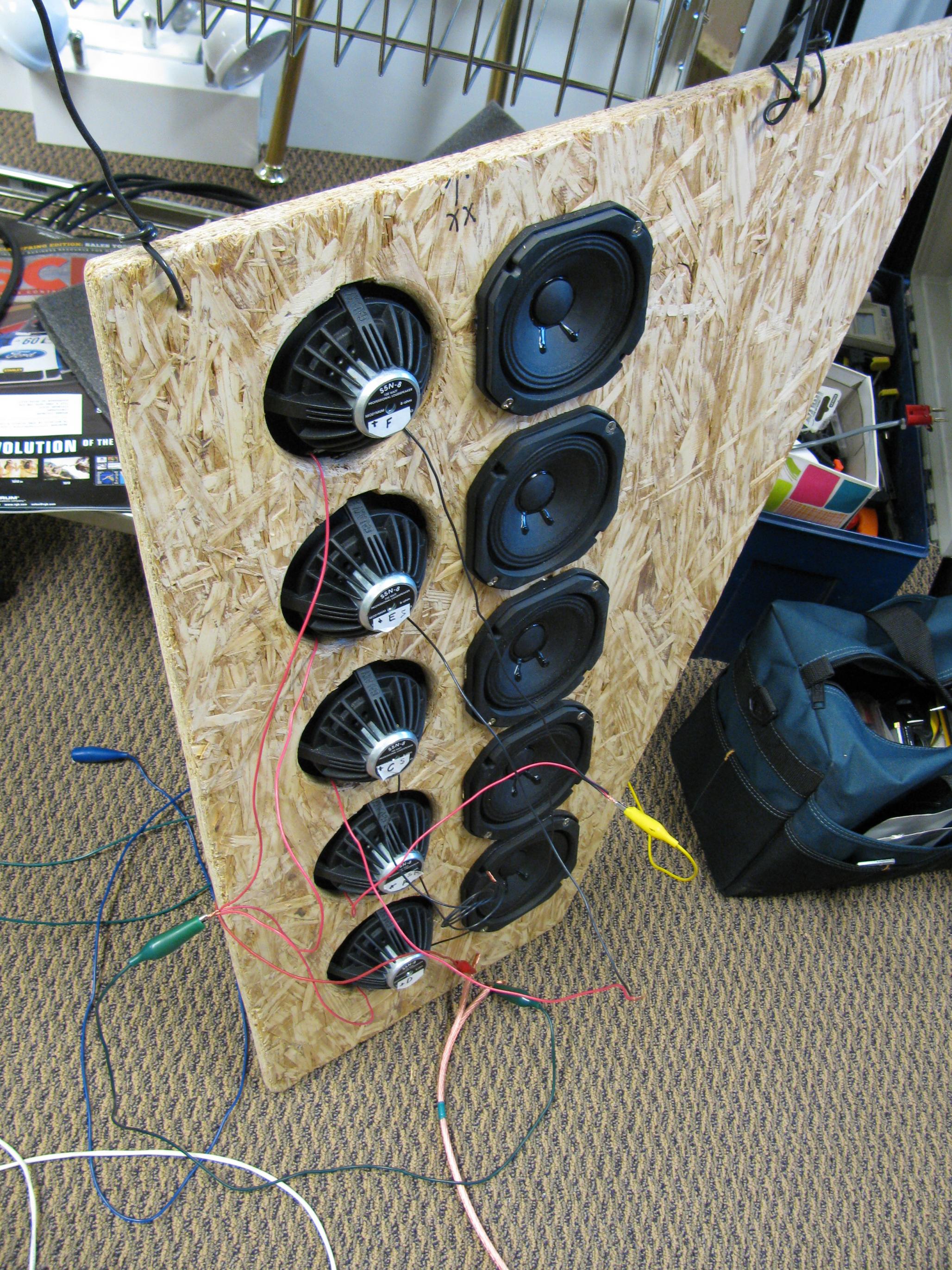

This panel, done in OSB, is essentially where we went with the two-row idea.
It is 29" wide by 48" long. I tried to center each row of drivers at the "Golden Mean" in each direction. Wiring is the usual "prototype messy" - but worked. This panel was taken into the sanctuary and flown behind the speech optimized loudspeaker. Eventually it was lowered to a point where it interacted with the angled side walls of the platform.
Obviously the best "activity" (stereo" is not an accurate description of the so-called imaging), is along the center of the center aisle. However, even off to the extreme front corners, where a "stereo" pair would only project the one device to which the listener is closest, there is a sensr of a Difference between what each ear perceives.

There will be a question as to why we went with two rows, instead of using the backside of one as the "back wave"...
Measuring the single driver on each respective side we found the expected 180Hz to 15,000 Hz response over about a 130-degree arc from the front side, and about the same low point up to 4K on the backside, rolling off fairly quickly.
Galaxy, by the way, rates each driver at 100 watts RMS, full bandwidth. If you're keeping track, that means the dipole should handle 1 kilowatt from 180 to 15K.
Purists will, no doubt, point out the time domain discrepancy between the front and rear rows. We found that, at a distance of about 20", vertically, and, from 15 to 45' away from the device, we couldn't accurately tell much difference by row location - even when the rows were "traded", front for rear.

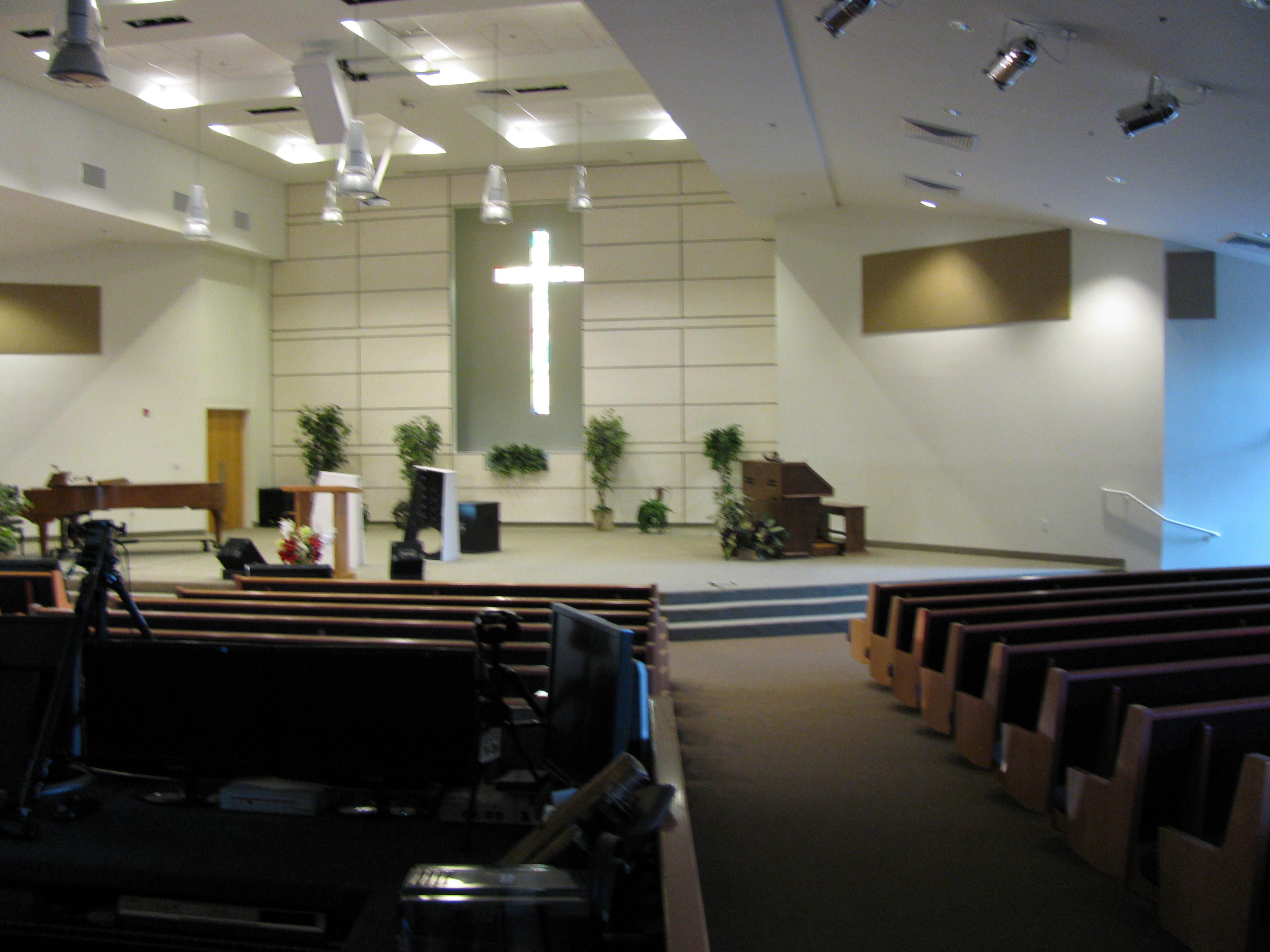

One last image for now.
This is the view of the main loudspeaker over the pulpit in the sanctuary. The space between and behind it, and the projector, further behind it, is where the device will hang.

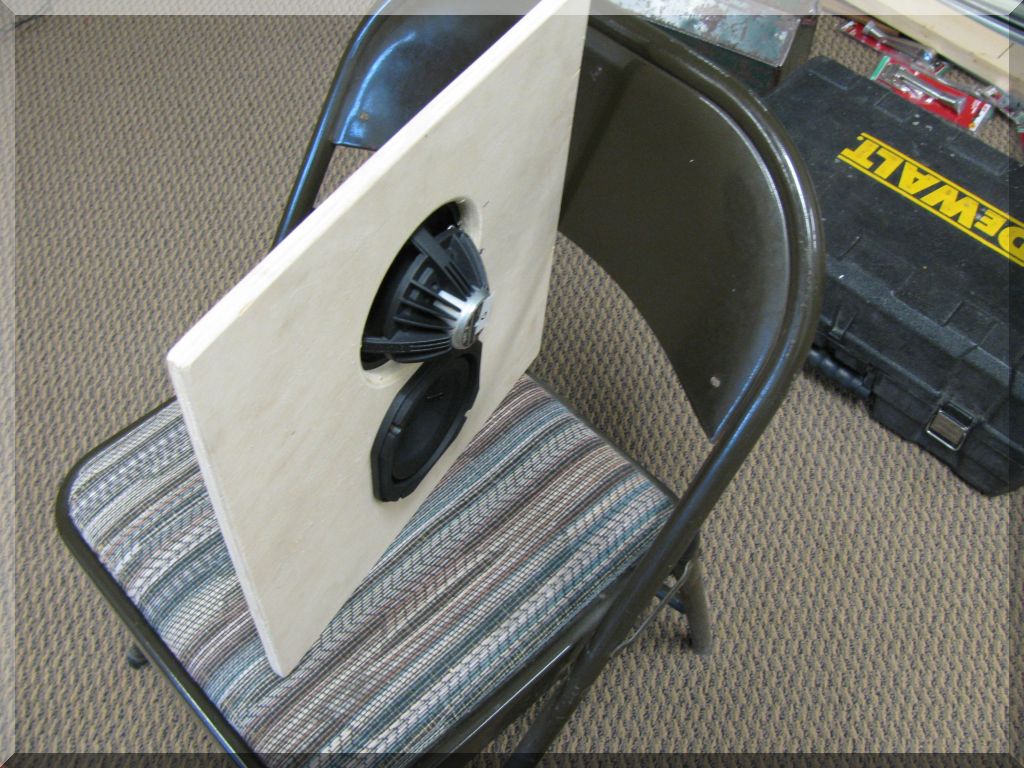

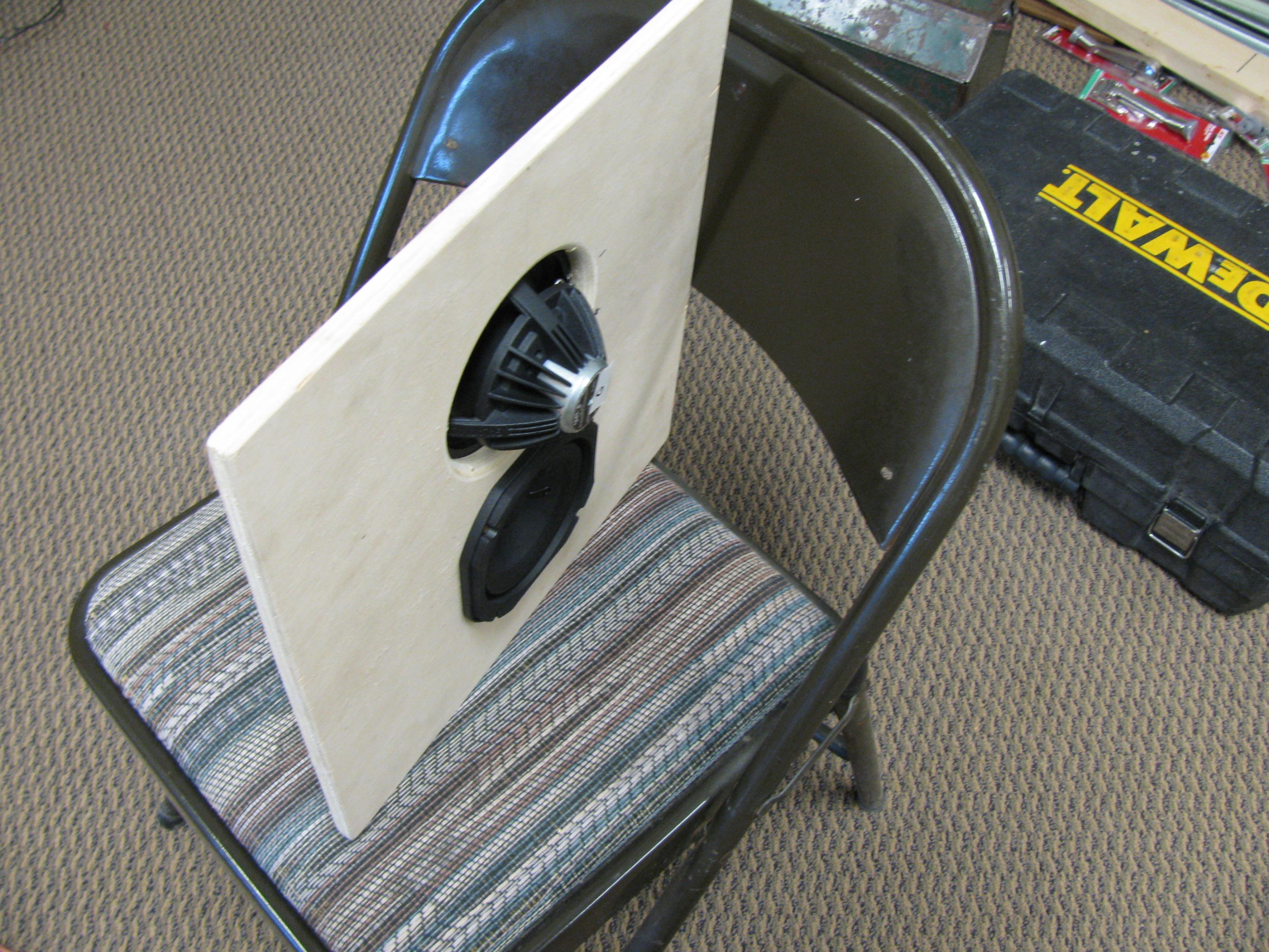

The prototype, with a pair of Eminence Gamma 15s for the low frequency content. There is reasonable response down to 50 Hz, without EQ to force it. We are using an analog electronic crossover with a sub-woofer option. We haven't tested for the optimum location of a pair of 18" boxes - but will likely put them at ground level. More on that, later.

An observation, now that the finished item is flying: The main loudspeaker (which I also designed to meet a seating plane geometry that would have forced us into an array (that would have had too many problems - cost, inter-box interference, and more), is now in a position to compare, sonically, to the dipole right behind it. I'm going to have to go back and fight with the DCX2496 and see if I can make the "box" sound more like the "open baffle"! Digital processing can only take parameters that are subject to adjustment and modify them to the point where the phase anomalies are mitigated. This should be interesting! Every body liked the original box. Most that have heard the open baffle, even standing in the null - or anywhere else seem to love its sound!
