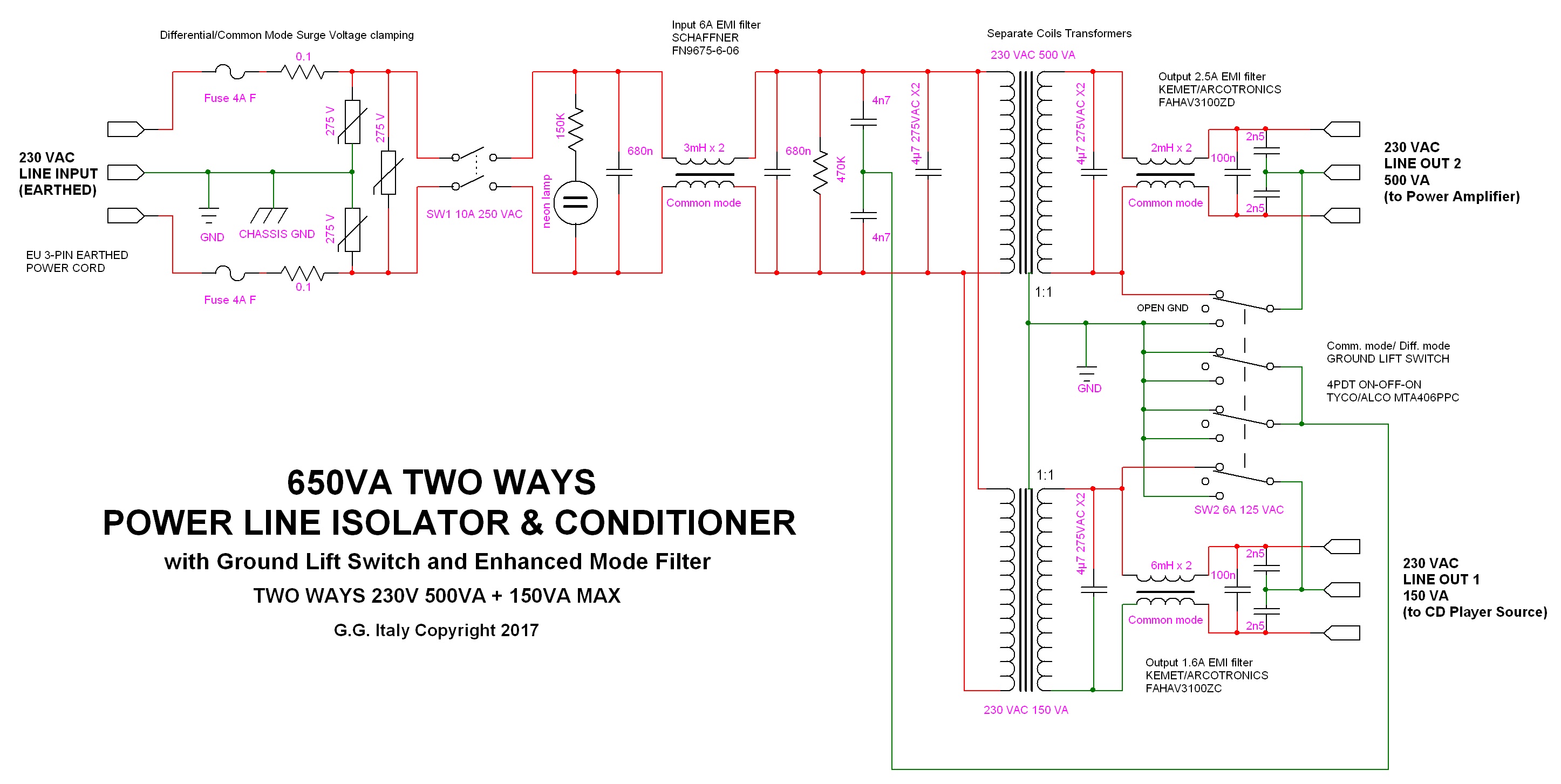

The cap is not a frequency dependent voltage divider. It is half a frequency dependent voltage divider. The other half is the mains impedance.
Noise source impedance plus mains impedance in parallel with load impedance, all at noise frequency.
Headphone systems could be potentially more sensitive to those shunt caps. I used about 3uF between live and neutral, the background's lot darker, overall less aggressive. But I would avoid inductive filtering like coils with magnetic core. They usually make harsh sounds.

The resistor could just damped the series resonance between the transformer's primary inductance and what-so-ever in his mains setup.
See this Link: Mains DC and Transformers ,figure 7.

Does he have a DC blocker? If not, there is no series resonance to damp.ApolloZhang said:The resistor could just damped the series resonance between the transformer's primary inductance and what-so-ever in his mains setup.

The concept of shunting your mains supply at your 'sensitive' hifi equipment connection point is that all manner of spike and transient currents generated throughout the house, or even external, will preferentially circulate along the mains cable path to your equipment. Your equipment is then likely to need more noise filtering than you first envisaged!
The only way that could happen is if you disconnect the load downstream, when you disconnect the power upstream.Hello,
Second, if you were to put this across the line voltage, need to add a bleeder resistor such that the cap gets discharged when the power is off. Otherwise it could be setting there with voltage across it and shock you badly.
