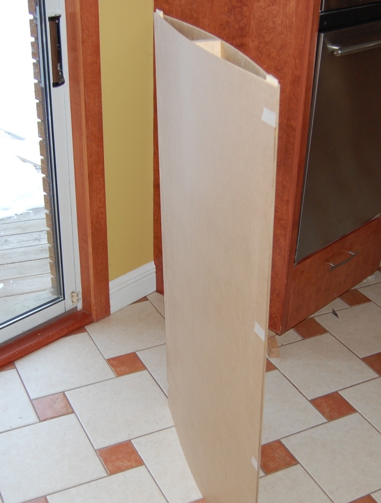

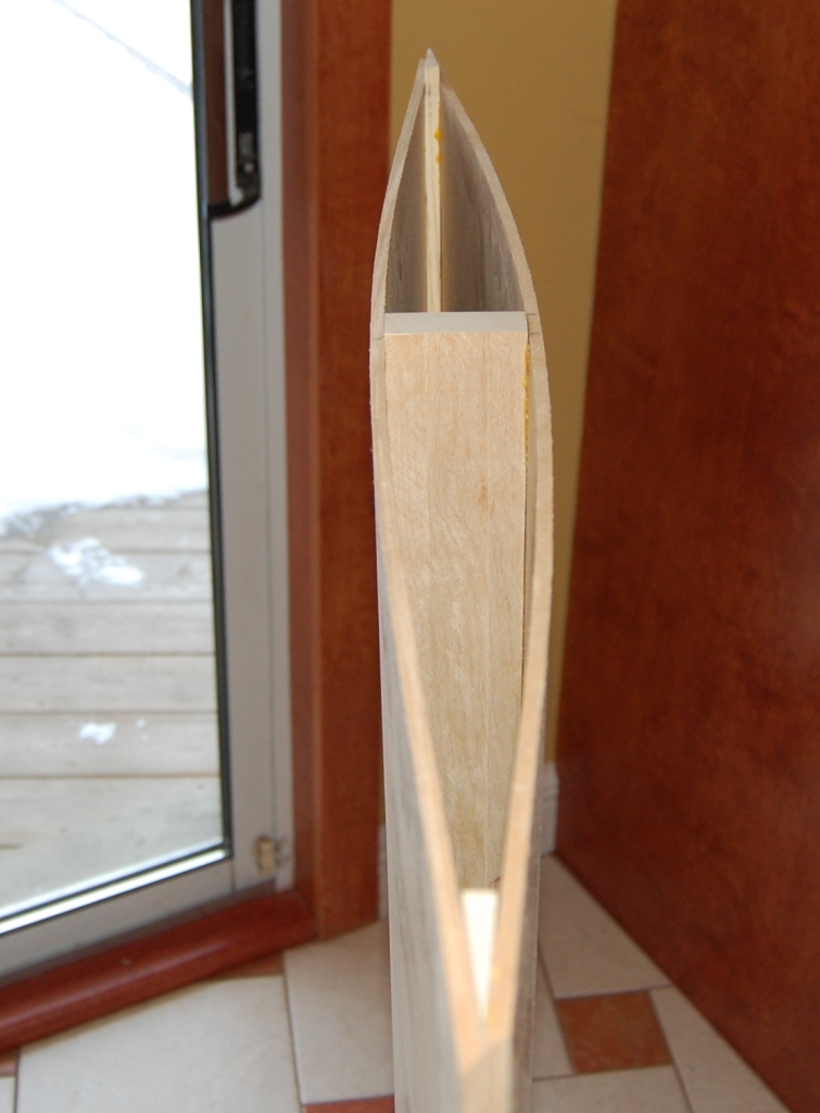

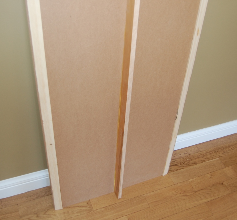

I have many parts cut and I have one of the biggest panels assembled:
I changed the dimensions slightly to avoid a lot of sheet waste. That panel is 48" high and 28" wide. In making the panel wider, I also increased the thickness of the backbone to 2". Also, you'll notice that the backbone is NOT steel - in the end I thought it would be less practical to try to glue steel into this position. The backbone is solid hard maple - 3/4" thick by 2" wide and should be strong enough here.
Gluing this together was a bit tricky, I glued the fillets(which I have made wider) and backbone to the outer skin first, let that dry and then glued on the inner skin, using a jig to clamp it and hold it straight on the edges.

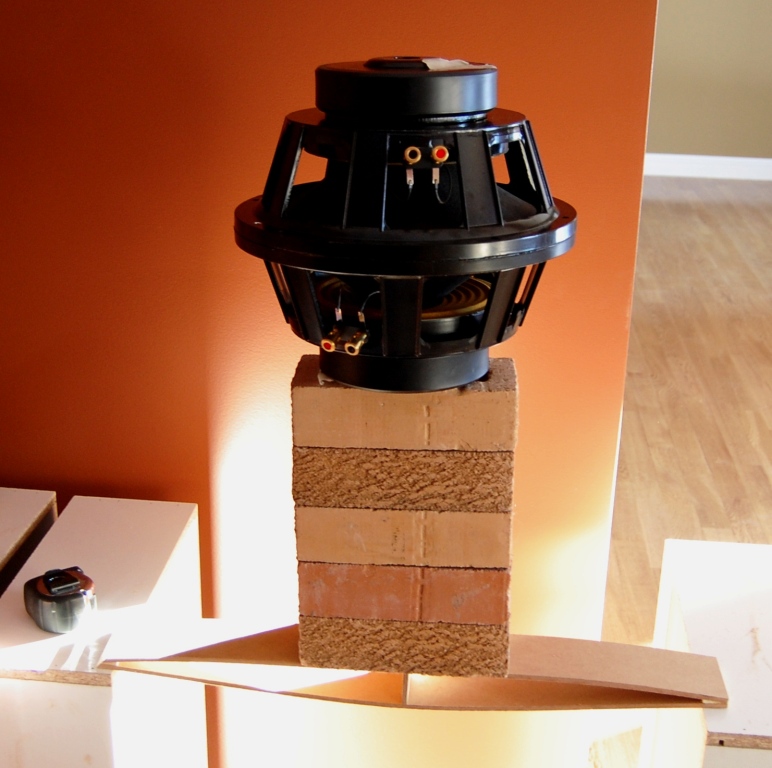

I did another load experiment on that mock-up piece, bringing the weight up to ~57lbs (25lbs bricks, 32lbs woofers :D). This much weight did make it deflect slightly:
If that section were full of foam I think it could easily hold up twice that weight or more.
It's the year of living dangerously so I left the speakers and bricks on there for about 2 hours (I did put a big cushion under it) to see if it made a difference - no measurable difference and when I took the weight off, it returned to it's original shape.
Yikes the weight of your whole project is resting on the result of your little wing experiment
No there is more to it than this. Any structure needs to be practically tested and compared. For example: I've already taken a strip of 1/2" Baltic birch plywood, put this much weight on it and measured the deflection - it was 3 times more (nearly 1/4") than the "wing". 1/2" particle board fractured when I attempted to place the first woofer and I don't think I need to say what would happen to just a double layer of 1/4" hardboard when laid flat.
This is just a demo - there is a lot going on in the completed panel and how it will attach to the rest of the box. The real test will happen when it is completed.

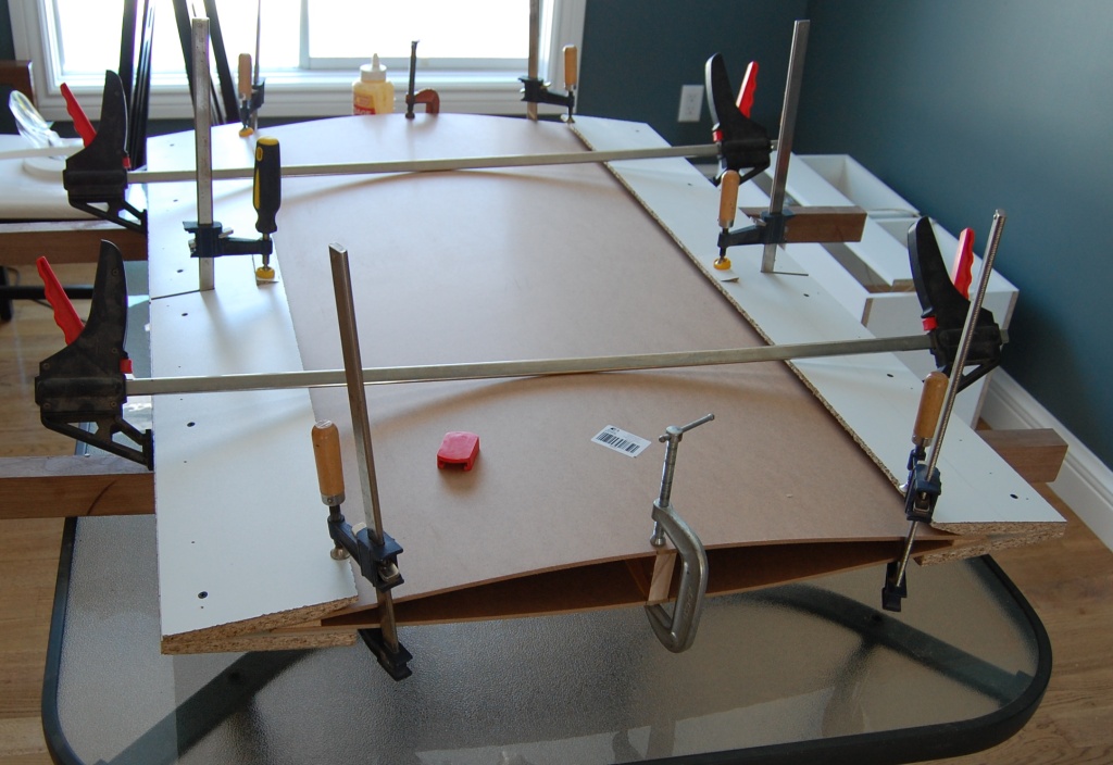

Here's panel #2 with the fillets and backbone glued in:
And here it is in the clamping jig with the inner skin glued on:
Part of the fun in a project like this is figuring out how to do these tricky things, like gluing the panel together straight and true.
