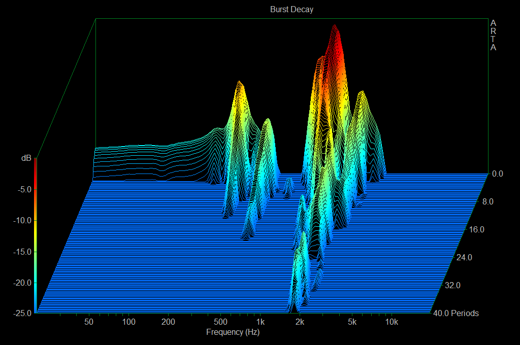

Oddly enough it didn't make much of a difference.
Measurement of the box in its original state:

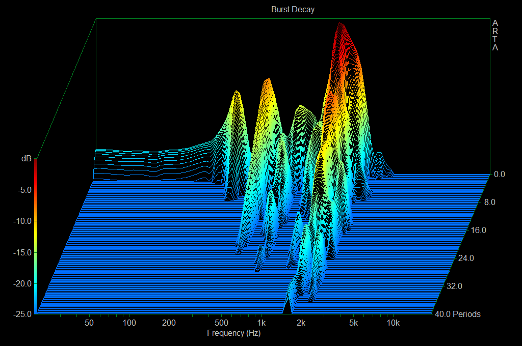

Measurement after I added the magnet brace:

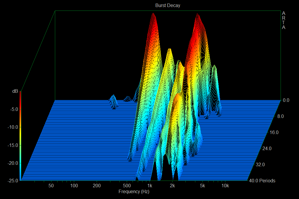

And measurement of the "sili-surround":
Without a point of reference between these, the results are pretty much useless. I didn't record the output peak on any of them and Arta putting the peak at zero db regardless of the output level makes this utility only useful for eye-candy.

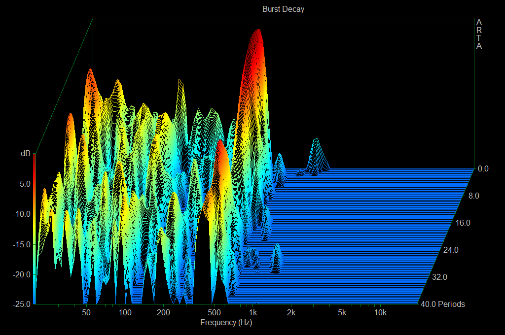

To give an example of what I'm saying, here is a measurement with no output - the speaker not making any sound:

Sadly true. That last post gives an idea of the background noise of your "house"

I don't think the furnace was running at the time but clearly seen is the fan noise (?) from the computer at 400Hz. It is the closest source of noise in any case.
And if you study the 3 plots above you can see that 400Hz peak - it could give some perspective on the actual output.
