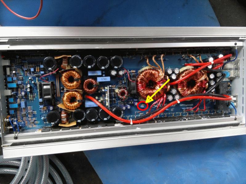

The resistor and capacitor you have circled are R70 & C37.
R34 & C34 are next to each other on the other side of the transformer, next to where the winding leg goes into the board.
R34 is a blue 33Ohm resistor
C34 is a 683K63 piece...
R70 reads 940Ohms
Nothing plugged in...
R70 reads 940Ohms
No, I disconnected the speaker wires.
I cannot get ANY reading at all from the RCA shields to the heatsink.
I can still get a reading of about 1000 to the negative terminal though.
Would that have anything to do with the big blue resistors between
-SP to heatsink &
-ve to heatsink ?
There is also that resistor that is between the RCA ground and heatsink too...
-SP to heatsink &
-ve to heatsink ?
Do you think somebody added these caps in?
