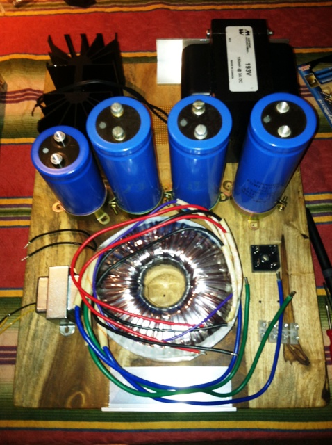

Here's a mono-block of the L'amp v193. It's in the "lay-out" phase.
I'm still on the fence regarding using the heat sink pictured. :scratch:
