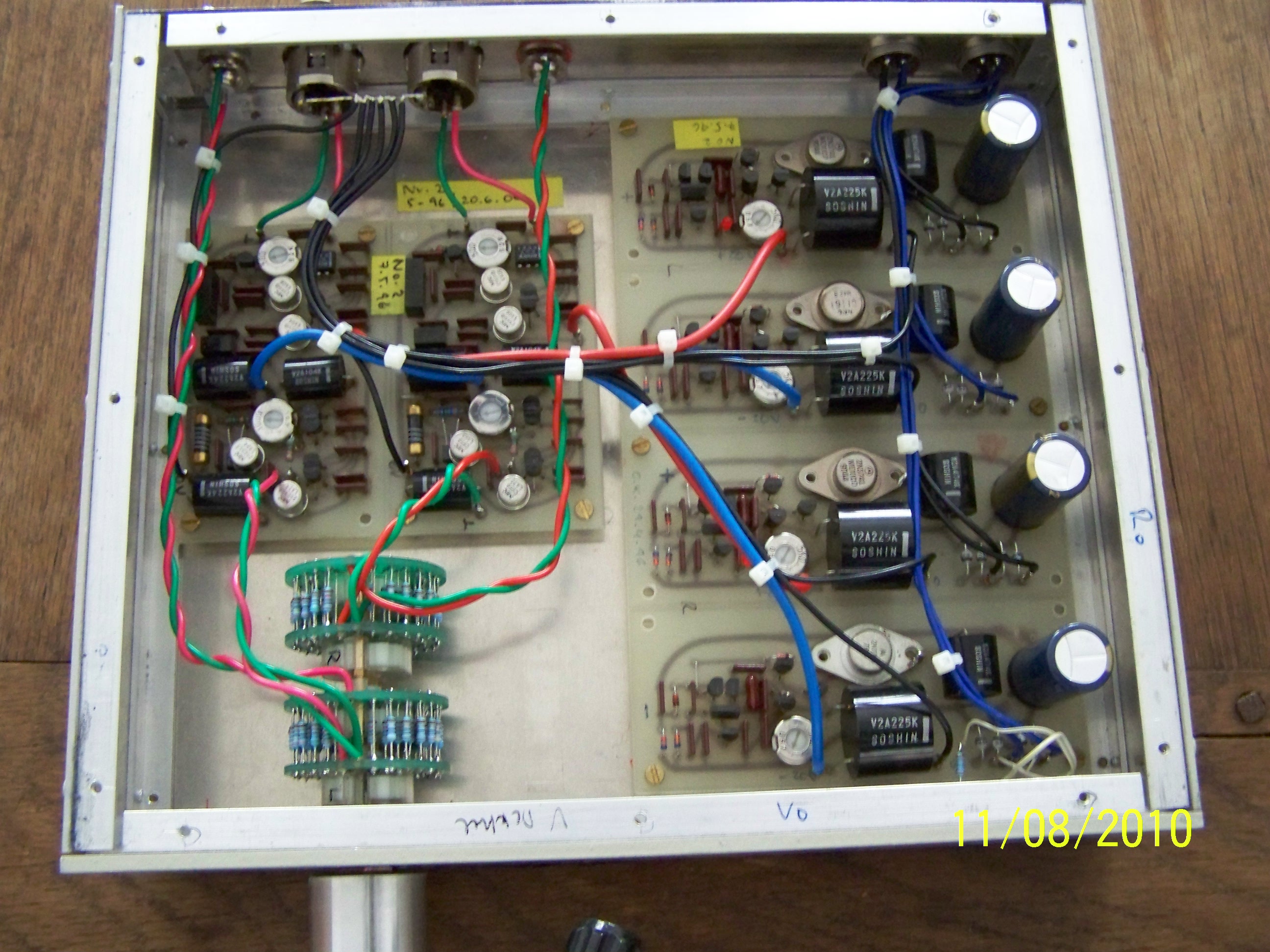

I soldererd a lot of these good old ELMA audio attenuators.
Yes! Elma are my first choice. Used by goldpoint and not hard to find in Europe.
But those i found are with single pcb (per channel) with little spacing, for smd resistors. I'll look further (or get the pre-mounted one)
Yours are stepped attenuators that have always a chain of resistors in the signal path. Mine only one resistor at each step. A couple of years ago I purchased the last two from a British distributor. They seem to be hard to find meanwhile and if you get some, they are quite expensive.
