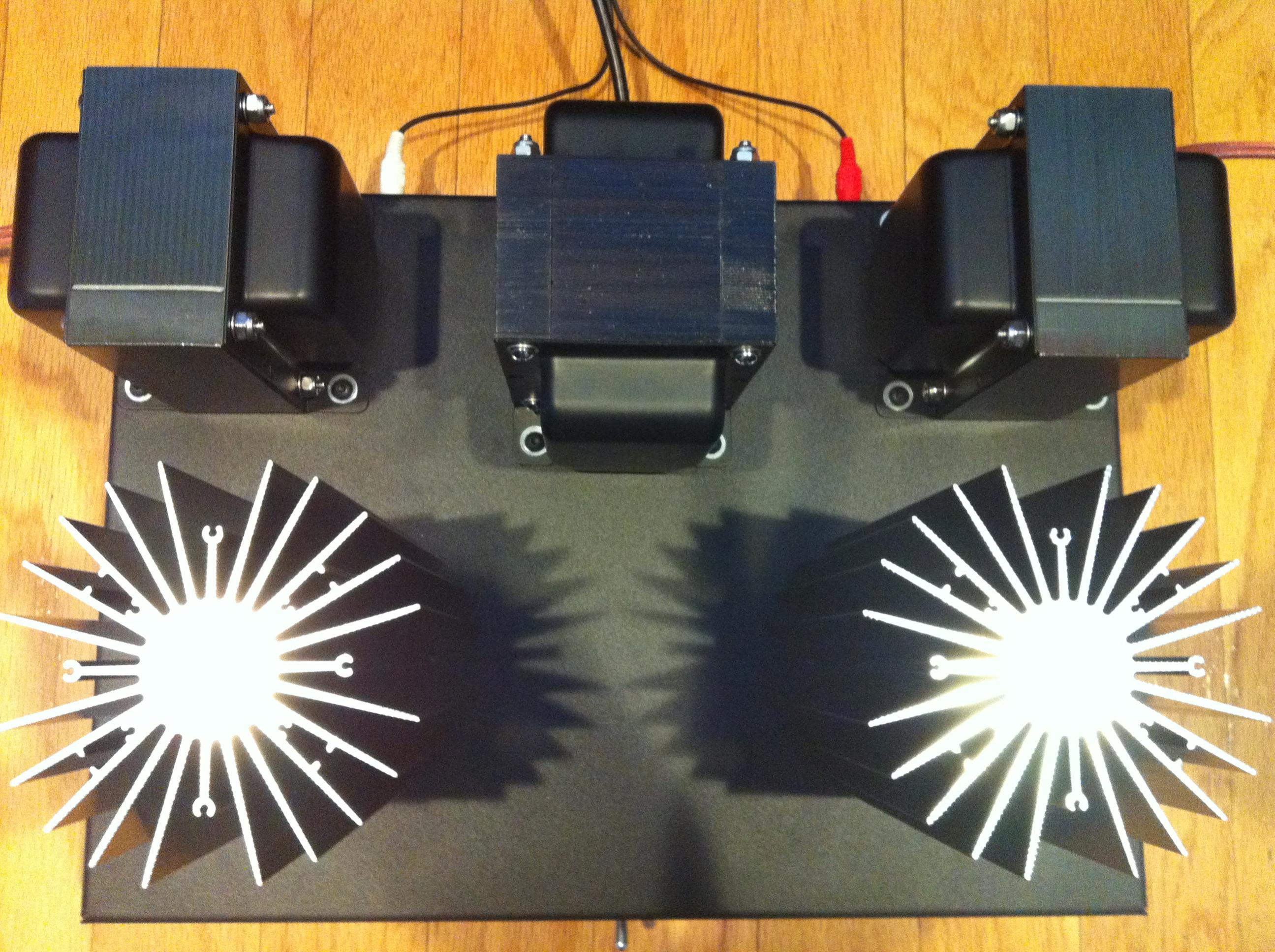

Here is my SIT amp loaded with 193V inductors. Big thanks to NP and Michael also to Wayne, Wrenchone and everyone that helped troubleshoot it at BAF.
Just in case anyone is wondering, the mounting lugs on big Rifa caps are internally connected to the negative terminal. So beware if you plan to use them for output coupling.
The description of the sound from the Firstwatt articles/manuals is spot on.:)

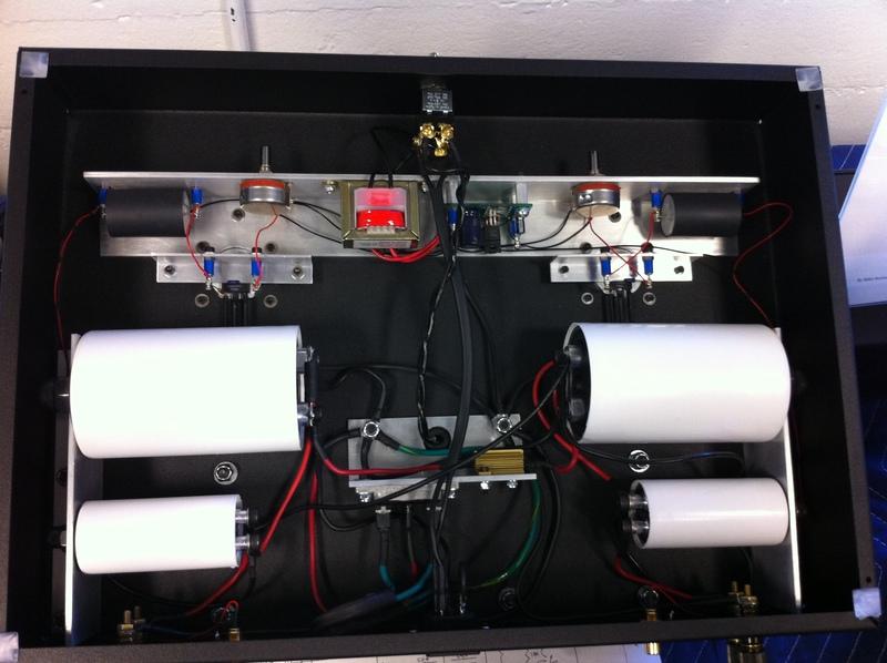

Here is an upskirt shot for those into that sort of thing taken by AMB at BAF. I still need to clean up the wiring because I was in a hurry to get it ready for BAF.
Thanks also to my friend David who took care of the machining on the heatsinks.

PSZ and everyone else - hindsight is always keen... The case on any comupter electrolytic cap is always at the potential of the (-) terminal of the cap, which is one reason why you see them often with plastic sleeving around the case. In the instance of the Rifa long-life computer ekectrolytics with the stud on the bottom of the case, well, that stud is at the same potential as the case/(-) terminal of the cap.This is not a biggie if the cap is used for the usual filtering purposes ( but not for negative supplies, obviously). When used as coupling caps, the mounting stud on the bottom of the cap must be isolated, otherwise you are shorting the amp output to chassis. Obvious in retrospect, but not on Sunday - sheesh...
