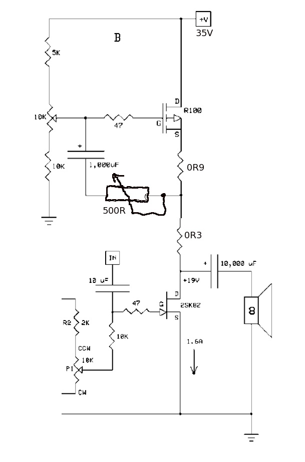

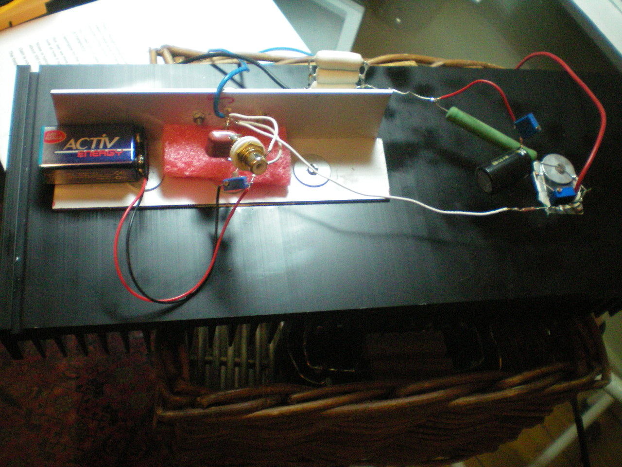

Hi SIT-Men,
I am onboard again, my experimental assembly is working.....
so my normal amp can work parallel for comparison (BJ2)....
and no more destroying the case by the 120th change...
look my newest modification of "nearly" CCS (tamed Mufollower) and my last circuit change.
I simply put together two pictures from Mike, the upper part is his suggestion for a CCS with SJEP120R100,
the lower part is Mike´s normal suggestion for the SIT.....
the changes for the Mu are the drain resistor of 0R3 for the SIT and the 500R pot going to the 1000uF going to the drain of the Semisouth.
With the pot I could make at a certain position the k2 dominant for for lower and higher volume levels, followed by the k3 in a constant distance.
Without the pot the k3 got very dominant putting the volume up....
So it has the Zen factor!
Next experiment will be the inductor solution.....
