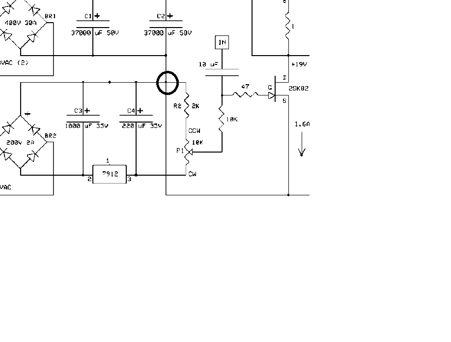

Hi Guys,
Just picked up four 2sk82s from circuitdiy.com. Looking to build the LAMP CCS.
Have a question about a connection. Not sure if it's a bridge in the schematic or a connection point. See attached diagram.
Also, I have a transformer that was used in the original Zen amp. I think it's an Avel-Linberg 28v, 6 amps capable. What is the proper transformer current rating for this project?
What isolation pad is used? TO-3 type?
So, to fire up the amp the first time, the pot is fully open, correct?
BTW- love the CCS!
If anyone is interested, the 2sk82s were $22 each. They also sell them in a set of 8 for $168, and they also sell complimentary N and P channel pairs. They take paypal. The site says they are guaranteed new. They are out of Singapore. I hope I bought the right thing!

Hello Marco
I will look into it, of course we will continue in the power supplies thread. The only extra info I will need from the guys in this thread is: How much more than 1.5A idle this amp can ask for peak power ref to nominal? Or it does not ever move even with resistive CCS? Thanks.
*With such a supply you will not need active CCS for killing buzz, you can keep it with resistive. Unless you like the sound of active CCS, but most of it is the PSRR and a bit the different THD.
