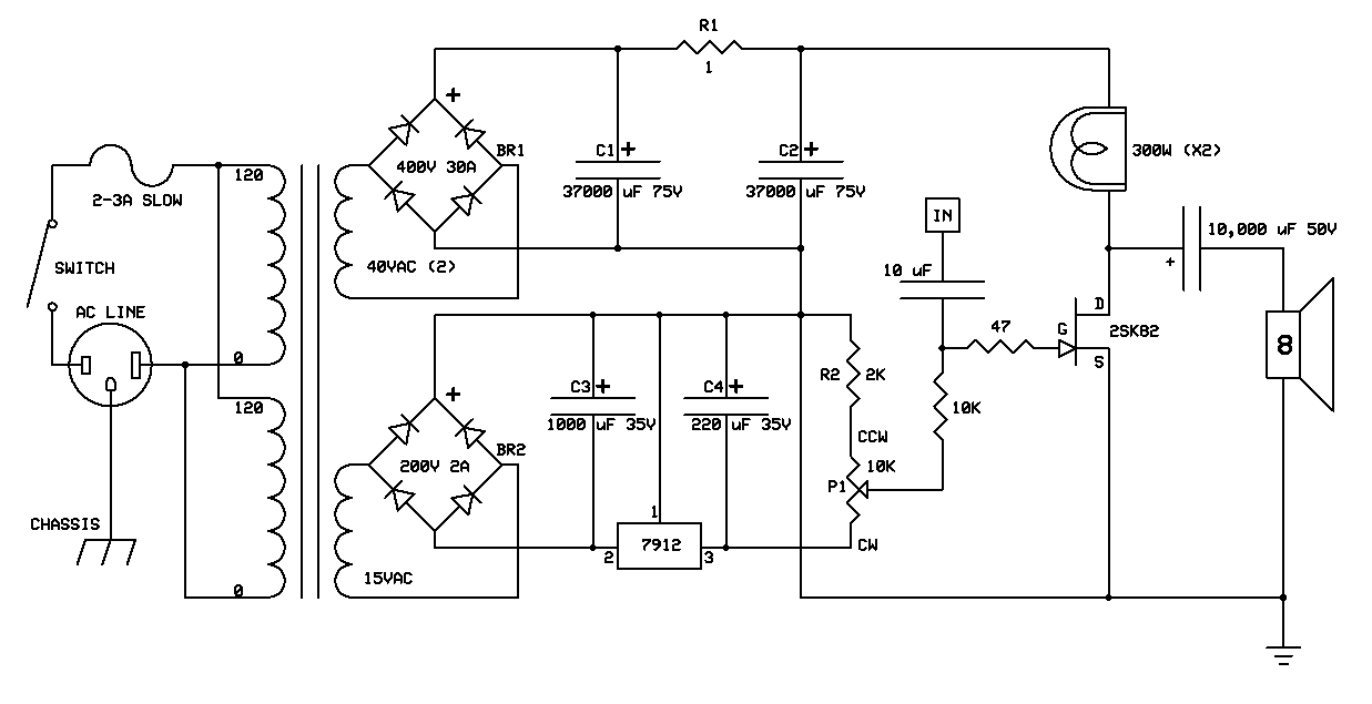

replace 2sk82 with 2SK182ES
hi,
after read most of this thread, i decide to build the L'Amp.
i have pair of 2SK182ES.
can i build the same circuit recommended here with only the 2SK182ES?
i know that i probably need to tune the bias to the sweet spot.
thanks

Go for it!
You should start the voltage with -10 and slowly going to something like -7.
You need a very good heatsink. BTW i use SiCs instead before i put on the 182ES because if something wrong, i don't like to break a 182ES...
resistor should be high power.
You are going to need a preamp with very low impedance and high voltage output.
I would also recommend:
- increase 10mF of out to 22mF
- put a resistor in source to ground of about 0.1 ohm, high power, i use arcos 100W, which are like a fortress.
yes start from -10 and then go slow... checking temperature and amperage. I would say to have about 2-3A and then later based on your heat sinks and PSU you can go higher. No need to go high voltage, avoid it. Go till 65V. For now, you can test without the zener protection, as long as you keep your input till 10V, which is very high

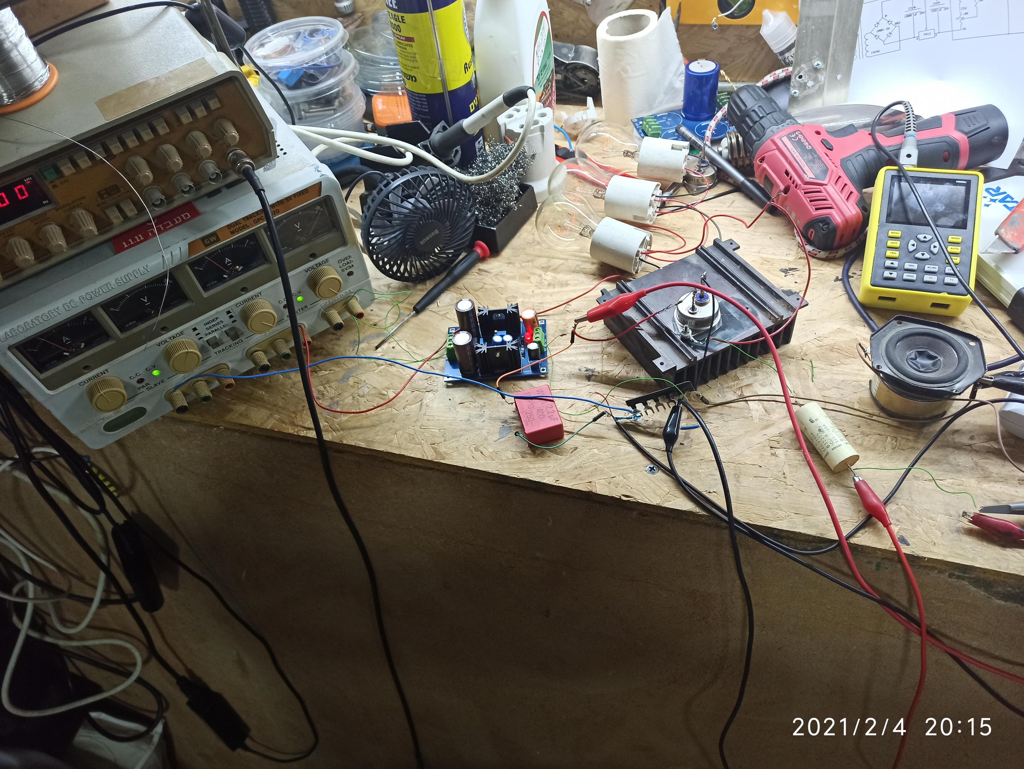

the setup is base on the L'Amp.
lm317 for the bias
3*regular lamp of 100W
change the PS to 60vdc
now its 60vdc with 0.5a and play fine, but way i cent increases the current?
edit:
strange: when i switch the lamp with 10ohm resistor, i can increase the current to 2.5A easy
