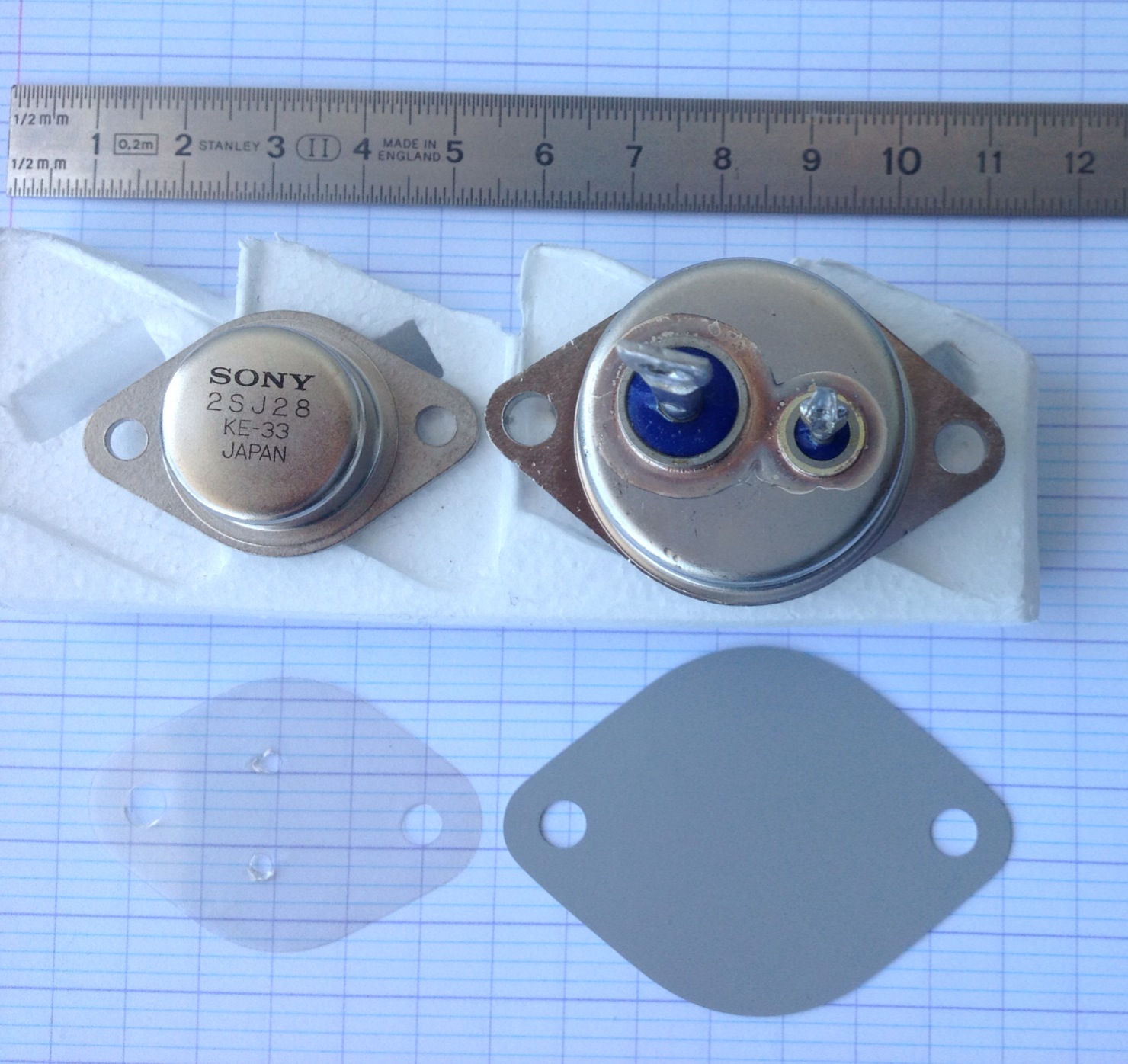

I've been having trouble locating any reasonably priced SITs except for the 2SJ28 - KF33 grade and while I have build a few amplifiers in kit form I'm interested in trying my hands at a scratch build.
What does it mean when people mention reversing the polarity if one plans to use the 2SJ28?

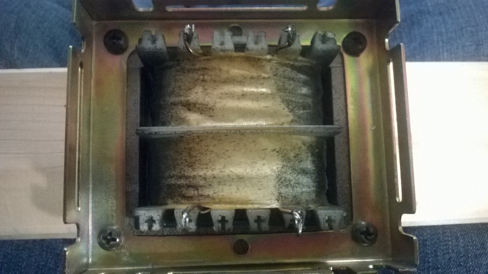

I have a big dual inductor (two coils in the same core, as you can see in the picture below), do you think I can use it for a stereo amp? Each coil measure 100mH, dcr is 1 ohm and they are rated for 4A each.
I ask it because I fear that the mutual interaction of the bobbins could cause bad channel separations at least.
Thank you for any help

In fact, the mutual coupling will be a issue. Probably is interesting to use it with coils wired in series, in one channel only. If you have 2 of it, will be perfect.Good evening DIYers,
I wrote on this thread some times ago, but still no amp made yet.
I have a question about inductor:
Maybe too much resistance? It would be near 2ohm.
It's a pity I have only one, I think I will use it for filtering purpouse (at least I think I can use it in a CLC filter, one bobbin per rail or both bobbins in series separated by a capacitor)
Thank you very much for the help DIYBras!

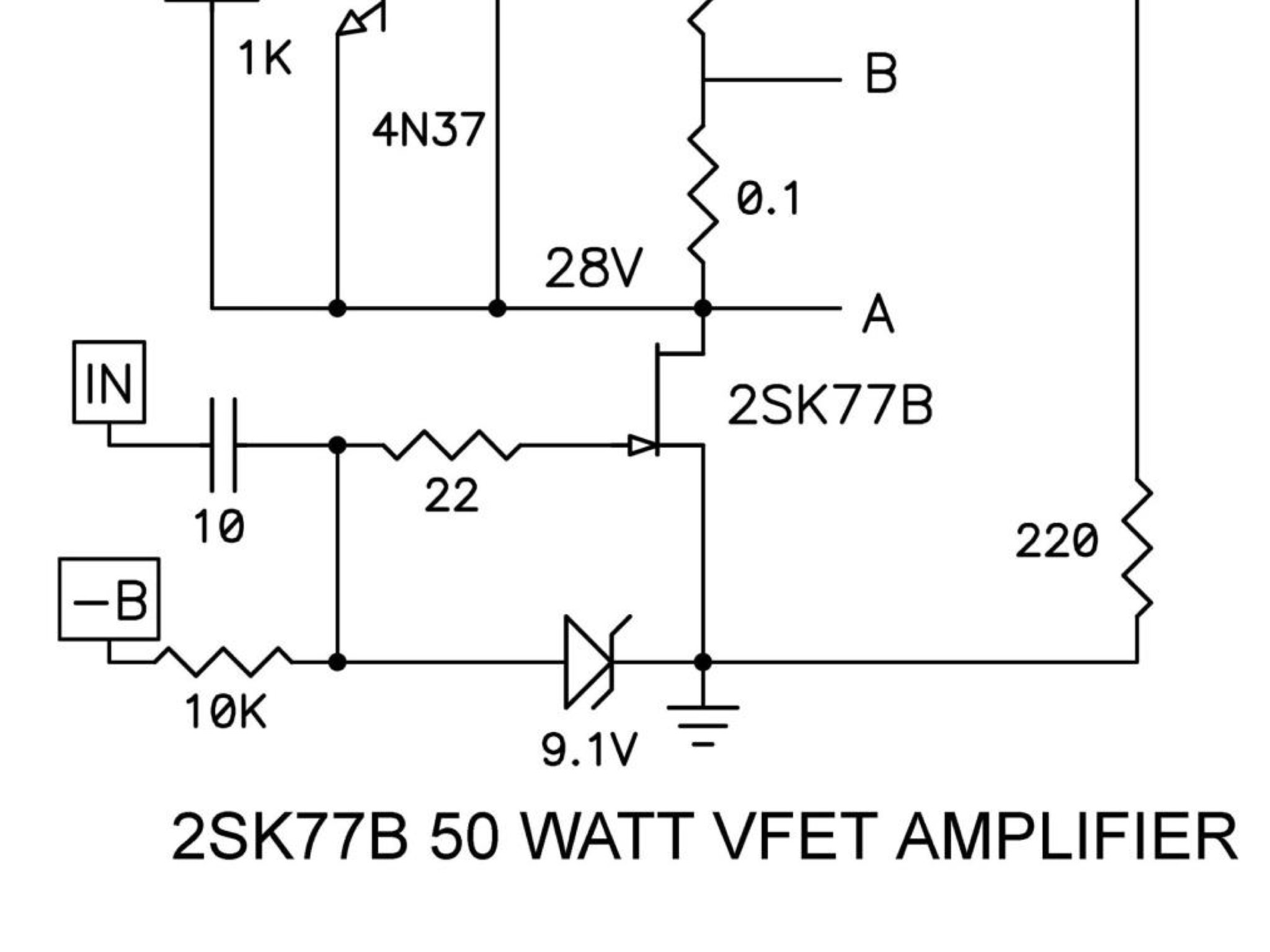

Protection by Zener diode 9V1
Remember from Papa schematic on BAF2015 vfet protection by 9V1 zener diode between drain and source pins.
Was for guys who use tube preamplifiers. Protect the vfets is always priority.
Any comments or recommendations how we can more secure L'Amp circuit ?

I was wondering if adding a main power supply relay on/off by bias voltage can avoid bias loss accident.
