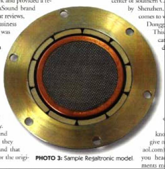

Regarding Neo, the only benefit with going to Neo over ceramic is weight. In a pro system with many drivers, this can be more critical. For a home system where it won't be moved on a regular basis it has no real benefit. With a neo motor we could get a TD15 from about 27lbs down to around 18-20lbs. A radial neo has the benefit of much lower flux modulation as the strong force of the magnet is right next to the VC. The same went for the old Alnico magnets that were placed in the pole right next to the VC. The full copper sleeve on the pole is just as effective at reducing flux modulation but has the additional benefit of linearizing inductance with respect to excursion.
