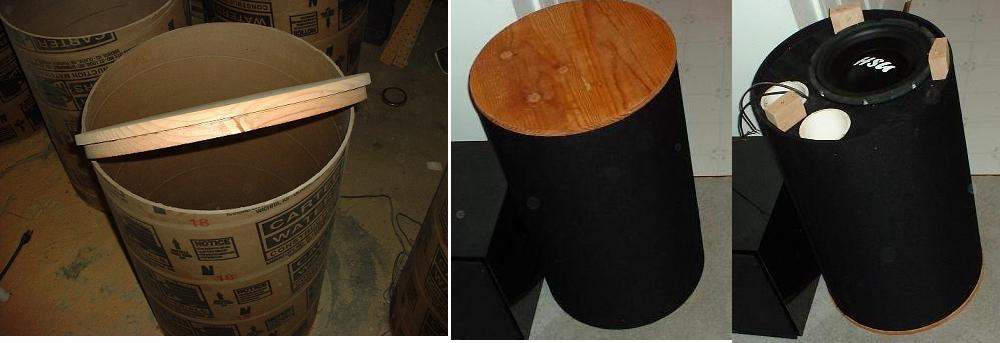

I've used these for subs in HT and in church's, up to 40x80. Only real problem with this design is it needs some more weight to keep it from jumping in the air. (had to add 10lbs of weight to the inside of cabinet) Sitting on it also works well.....
This design came directly from the good Dr. himself.
